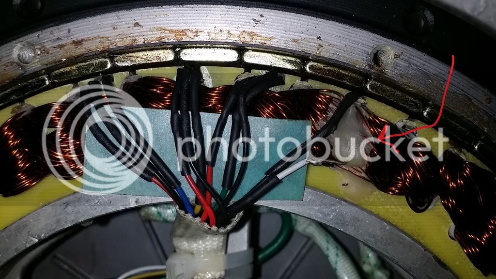

I think the MXUS temp sensors are not calibrated for the adaptto. It doesn't make sense. I have the V2, there is very little drag. The Eddy resistance is way less than the all of the 54xx motors I have ran, and feels less resistance than the H4080. In other words, the V2 just spins very freely. When I have a WOT blast down the road, I let off and it coasts way further than my Fighter and Bomber would. If not Eddy resistance, what else could it be? I don't have any experience with the V3, so can't say. I can tell you the weight reduction is a huge benefit. When I replaced by Bombers 5404 with the TC4080, I couldn't believe the improvement. Of course thats more like 10 pounds less, but still, its way way better in the handling department. So much that I would sacrifice power and heat build tenancies up for the lighter weight option.
Rix, the thing is that they just epoxied the KTY 83 sensor to the windings as you can see in the picture. What ever that white stuff is is very hard. I did the same thing with my KTY 83 sensor in my cromotor but I used thermal paste. Not sure if the way they epoxied it may make the temp probe read higher, but they really made good contact with the windings.
You can't really calibrate these things, but they do have different versions of the KTY 83, like 110, 120, and 130. Not sure if they used a KTY 83/110 or if they used a different version like a KTY 83/130 if that would make a difference. The ambient temp seems to read correct, if it is 60F in my basement my MAX-E motor temp is reading 60F.
The reason I brought this up was the TC40xx temp sensors are different from the H40xx sensors. When I ran my TC on my FIghter, it over heated instantly even though the motor was cool to the touch. I contacted Clyte about it and they confirmed there were different sensors for the motors. Kenny referenced the difference between the sensors, don't ask me what they were, I can't recall. So I figured the same thing could be occurring here. Maybe not though. I don't know for sure, just guessing. Still as far as the stiction and funny noise go, have no ideal
