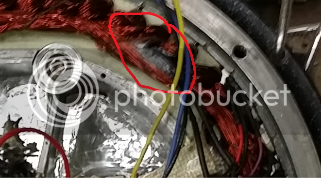

What concerns me with the MXUS is that most likely the thermistor is fine, there are actually two thermistors on the MXUS Turbo so I can switch to the other one. What is concerning is that it seems the winding temps get super hot but the heat is not being transfered to the motor case. There is a good chance that the thermal path from windings to stator is not as good as the Cromotors.
It seems like this shouldn't be but the motor housing is simply not getting hot and the winding temps are getting super hot.
This is not the case on the cromotor where the motor housing gets super hot as the winding temps get hot. When the Cromotor reaches 200F+ range the motor case is burning hot to the touch. I've yet to get the MXUS case more then warm to the touch.

Offroader, Did you really had the temp sensor on cro on the same spot as on mxus?
croatians usually put their sensor on the stator
https://endless-sphere.com/forums/viewtopic.php?f=7&t=61496#p918631
This will give a whole different measure - it will take a lot more time to heat up the sensor on the stator compared to a contact directly on windings.
Having a sensor hitting 150°C during a peak on windings will not give you a hot stator nor will it have impact on the outer case.
But if you heat your windings for such a long time that your stator becomes 150°C this will heat you outer casing by a lot!
So placing the sensor on the stator instead will probably give you about the same heat experience as you see on your cro.
Allex, I had to place a new KTY sensor because the NTC10K was not reading lower temps on the max-e. I placed it inside the windings using your thermal paste method. So it is inside the windings but questionable how well the thermal paste is touching the windings and the thermistor. MXUS places it on top of the windings and uses some kind of thermal epoxy so it is very secured to the windings.

Apologies for side tracking again, but out of interest where was the NTC temp probe positioned inside the Cro? Was it on the stator or on the windings?
Originally Cromotor placed the thermal sensor epoxied just below the windings, as shown in the picture below. This was a NTC10K
But I have since replaced with a KTY83 inside the windings as best I can with using thermal paste squeezed into it. Then I used silicone on top of that to hold it into place. As shown below which is the best picture I could find. What you are seeing is the silicone on top of the probe and wires.
Would there really be a huge difference in air temperature between the two probe positionings? Or is it more important to know the surface temps of the copper or the alu stator? At the end isn't overheating mostly a concern about magnets, hall sensors and wire insulation? Or am i missing something much more important :?
