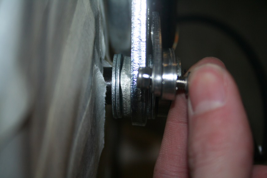

I ended up test fitting the front hub motor and on each wheel there is 2 washers on the inside of the forks and 1 on the outside (then the nut on each end) but I was not able to fit
One of these washers (the second one from the hub motor) has a little lip on the end of it which im guessing helps to stop the hub from spinning in the dropouts
My only issue is, if I run 1 washer inside each fork there is too much space from the fork to the hub, and if i use 2 washers inside each fork on the axle there is not enough room to slide in the forks.
Has anyone else had this particular issue? Its like I need 1.5 washers haha

IIRC, http://ebikes.ca carries spacer washers in various thicknesses.
Your local hardware store probably also has washers that will fit.
Alternately you can hold a washer with vice grips and use an angle grinder or bench grinder to shave it down.

Thanks for the heads up. I was worried if they weren't elongated, but then again I am using a torque arm too.
Spacer washers are just washers; doesn't matter what shape the axle hole is. Only the tabbed washers would make any difference not having the axle-shaped hole.

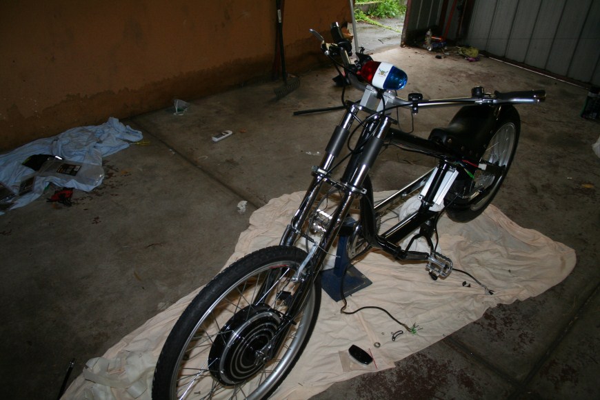

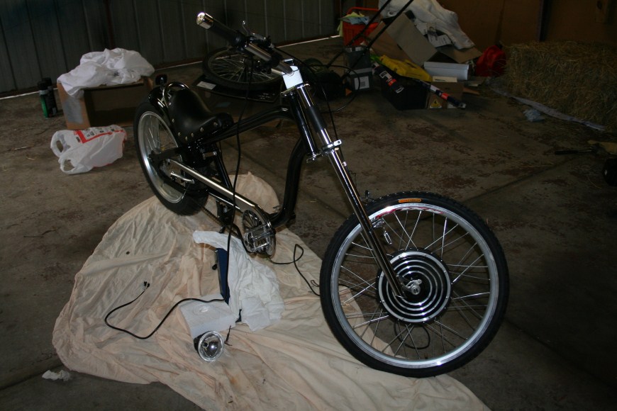

Finally I have some decent Photos of my bike :)
Here is the beast in all her glory.

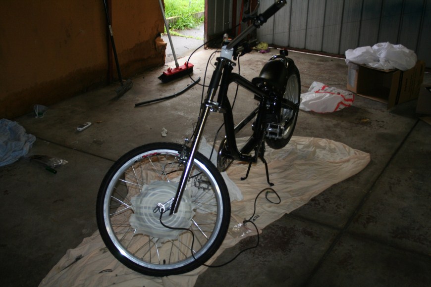

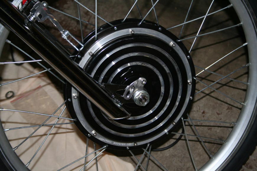

I made a bit of progress today and mounted up the Hub Motor to the wheel.

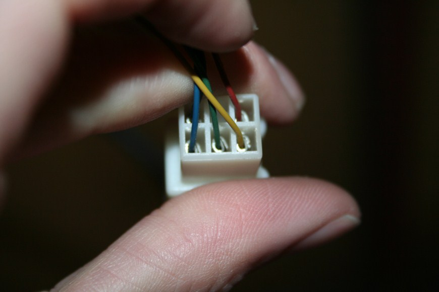

As recommended by members on here I was sure to take a photo of the hall sensor wires so once they are depinned I would know where to put them again.

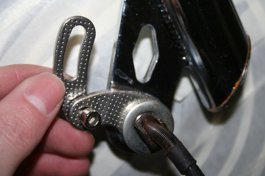

Here is my mounting of the hub motor with washers. In Order from the Hub itself all the way to the end of the nut I used:
Washer – Washer – Tab Washer – Drop Out – Washer – Washer Torque Arm – Washer – Nut
I am wondering if I used too many washers haha They were required to space out the hub correctly. The dropout has barely any compression as the washers shimmed the inside much better than the factory washers included in the pack (too wide).

I taped up the hub so it wouldn’t get scratched while mounting it in the dropouts. Slowly coming together.
Goodbye protection tape

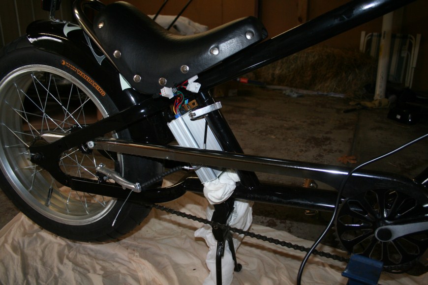

The next thing as to find a good place to mount the controller. I was able to squeeze it in nicely behind the seat. I will be using P Clamps to mount it to the seat shaft. As a result the wiring should be really neat.
The top plate of the controller looks rusty but its actually the reflection of the wall opposite (covered with wood lol)
Here is another photo (with cloth to protect it from getting scratched up.
Here it is in all its glory. Delicious. Can’t wait to fire it up.

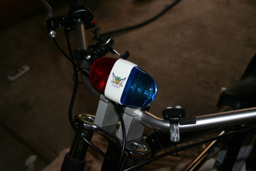

As a joke I bought one of those police alarms haha. I jokingly mounted it to the front (visible at top of handlbars) and its extremely loud and I can’t stop laughing. It won’t stay don’t worry, great for a laugh though.

I noticed in my pics just then that I put the torque arm on the wire side. I also noticed there was no thread on the end where the wires come out lol.
Is it normal for the droputs to have some rounding in them at the very top? Just looks like part of the design. Not all the for out has this but I could rotate the axle a few degrees inside the dropouts.
Would it be more appropriate to put the torque arm on the non wire side?? I was thinking of running 2 but space is a bit limited on the wire end.
