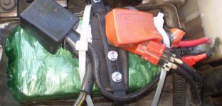

My lead POS car battery crapped out a few months ago. Since I had some A123 M1's not in use, I decided to make my own car battery. All of my M1's were balance charged about a year ago after capacity testing them, so I picked 24 that were the closest in capacity and current voltage. Matching based on capacity and self discharge seemed good enough for me.
Build procedures:
First, I used polyurethane glue to the cells in a 6p x 4s arrangement. They're the original paper wrapped kind.
All had tabs on both ends, so soldering six 4s strings was simple.
Then I stripped the insulation off of some 14ga zip cord to parallel all 6 at the cell level.
First I tinned a spot on the tabs for the parallel connections between the tab weld to the cell and the edge of the cell with the
positive end (the flat end on M1's) at that series connection. The button end have + from the can and - at the button in
close proximate, so I minimize work there.
Then I soldered a single piece of the bare 14ga to all 6.
At the positive and negative ends, I used 6 equal lengths of 10ga, 1 connected to each tab, to join together as one with a
piece of normal car battery cable that already had an automotive size ring connector. These are taped up to prevent shorts
all the way until the battery is ready to install in the car.
For the balance tap I attached a normal 4s plug and wires used for RC.
Then I painted it with a couple of coats of electric motor high temp spray paint, and gave it a good double wrap of duct tape
for good measure.
The 4x6 fits perfectly in a 3L soda bottle with smooth straight sides, so I cut the top off one and slid the pack in.
Using a stovetop burner it shrunk down nicely, saving the open end for last. After feeding the terminal leads through holes,
I trimmed and folded the end so it was mostly closed.
Then I used silicone to seal it up, and let that cure for 48hrs, so no acetic acid vapors would be sealed inside in the next step.
Then I cut the bottom out of another bottle, slid the terminal leads through the top and slid the whole battery in and shrunk it
and sealed the bottom end in the same manner as the first bottle. I also used silicone to form a plug around the wires exiting
the soda bottle top.
After the silicone was cured a nice wrap of electrical tape near and on the soda bottle top holds everything in place and limits
the flex of the terminal leads so they can't get worn through over time on the lip of the soda bottle.
Sorry I forgot to take pics while building it, and I waited until having it in service for a few months without issue to post about it. It has only a human BMS. I checked it for balance after each use at first, then weekly, and now that dry season is starting it will be when I think about it....monthly at the most frequent. For a long trip I'll just connect to the balance tap with a long run and have an HK cell level alarm in the car. It's been perfect and functions far better than lead, with the minimal sag really showing in a faster cranking starter. It ain't pretty, but it's protected enough that with a bit of attention to seal the terminal connections and balance tap, I'd have no problem using it in a boat or on an ATV.
The straps and battery terminal covers were required to pass vehicle inspection here, which it did with flying colors.

Yeah, the lack of sag helps a lot. I'll get my buddy to test it on his car battery tester when I bring a load of stuff to his auto shop. Just one trip with the car, and then ebike commutes to use all his good toys, I mean tools, that I don't have. :mrgreen:

I have only the old M1's from Dewalt packs, all wrapped in paper. I wouldn't glue the plastic wrapped ones like this for the reasons you mentioned. I haven't seen the pack get past 14.5, so I think I'm ok in terms of the alternator output. I have some of those cheap 2s-8s cell voltage display units with alarm (LVC only though), and will run an extension into the van to keep an eye on it for longer trips. I always have ebike tools and stuff when I travel, and worst case I left the car battery terminal connectors in place, so getting stranded for long isn't possible.
My biggest concern is high temps in the engine compartment.
If I get just 250hrs of usage or 250 starts out of them, that's 4-5 years for me, I'll be tickled pink.

OK...Temps under the hood are probably a bigger concern for your climate than here, though in the summer it can be a potential problem here as well. If you can't get them out of the engine compartment (and who wants to run big copper through 1/2 the vehicle?) heat shielding or a small fan might be viable. Monitor temps inside the pack if you can, and you can make an informed judgement. As long as you're not getting above 40 C or so for extended periods of time, there should be little impact. If you reach those kind of temps just sitting parked, you'll probably want to find a shadier spot to park. If you can avoid lots of high temp time and the cells are in decent shape, I would think 4-5 years should be easy for the duty you describe.
he would not need to run large cable through the vehicle. he could mount the battery under the dash along with the BMS and then pull the battery cable inside the cabin through the firewall and it would be plenty long enuff to reach the starter. the charging cable would not have to be substantial and he could cut a bunch of the shunt wires off of the BMS to prevent the alternator from charging the pack too fast. then for the starter current he could bypass the BMS on the output and use the discharge mosfets for an led signal light providing some info about the status of the pack itself such as over discharged.
Vehicle won't pass annual inspection here without the battery strapped down on the battery tray.
FWIW I live in the mountains where almost every day is like a spring day where you live. Lower latitudes doesn't mean it's hotter, especially when the Caribbean and Pacific are less than 100mi apart. The sun can be brutal, but that's what trees are for.
Sounds like you;ve got it licked! Let us know how it holds up over time. No salty breeze where you are, is there?

okashira,
These are real A123 M1 cells harvested from warranty return DeWalt 36V cordless toolpacks that I bought several years ago. They're the 26650 cells that A123 rated at the time for 30C discharge and 10C quick charge, though the nickel tabbing used in those tool packs limited current to below the cell capabilities. The 6p4s pack cranks the motor over so much better than a standard car battery that I think 6p is overkill, and if I make another one I'm going the route Doc did and use just 4p4s. In fact, since I still have plenty of leftover cells and 4p worked for Doc in Canadian winters, I'm going to make a little 4"x4"x2.5" or maybe even just 3p4s jump starter pack to keep in the glove compartment. Whipping out one of those with short leads just long enough to reach car battery terminals and spring clips modded for high current would be too cool the next time someone asks for a jump. :mrgreen: Plus it would work better than cheap jumper cables could ever dream of.
wb9k,
Why should I be concerned about salt air? The pack is seal in a double layer of PET bottles with silicone completing the seals, so it's submersible as long as I don't dip the terminal leads or the balance tap plug.
If the paper sleeve becomes impregnated with salty water, it can become conductive over time. Now you're back to needing physical separation of the cell groups. You're right though, I think given the level of splash protection you're affording here is plenty good enough that this should not be a concern for you.

Thanks for pointing that out, because humid salt air soaking into the paper never crossed my mind. I still have lots of cells with the paper wrappers. If I was building for marine use, which would you suggest, painting the paper, or duct tape (or similar) as extra insulation between each series level, or both?
