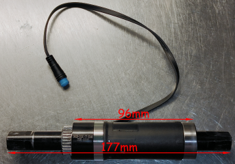

I have a lankeleisi mg600 plus 2024 model eFat and I have been having issues with its torque sensor. For whatever reason the torque sensor seems to break within 2500-3000km of cycling and it does not seem to matter if I ride during winter or summer, as the first torque sensor broke during winter and I replaced it with another one that broke during a dry and hot summer, or more precisely, this week.
This is how the thing looks like:
When the sensor breaks, it starts behaving completely random, the assist level fluctuates or it might even drop assist power to something like 5-10% from maximum. I was taking a video for "buybestgear" and "lankeleisi-eu" and I had already sent the video, when I noticed something that happened during the video. There is black dust-like particles falling from the sensor when I rotate it, I took a screenshot of it and marked the area where the dust is falling from and how one can see some of it already fallen on the wooden surface below the sensor. On further inspection, the dust is actually very small metallic flakes that shine under a flash light.

This seems to be a KCLamber product:
All of this bottom bracket torquesensors are known for not being reliable. Sempu, ERider...
There are some reports from users of the Cycle Analyst, that grounding the sensor GND to the bike frame helps somehow.
If there is metallic dust, something is wearing inside. If you're willing to open up one of the failed units, it might be possible to correct the problem with a different part if it's something commercially available.
Additionally, if the sensor itself is magnetic in nature, and the dust is magnetically reactive, it may be affecting the sensor operation. Cleaning the dust out may fix the problem, at least until more of it forms from wear.
In this event, if the wear only occurs up to a point where the metal being worn off no longer rubs against whatever is wearing it, and still functions correctly, then it wont' fail again after this (at least, not for this reason).

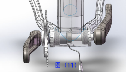

I received the torg2h today. Some notes as the installation is different from the usual "open drive side first":
  • the drive side BB cup (spider/chaingring) must be screwed in first as it has the teeth that hold the torque sensor body in place and one does not want to rotate it when the sensor is installed
  • next the sensor cable needs to go through the hole that is in the bottom bracket and then one can push the torque sensor body in carefully to avoid damaging the sensor cable
  • after all that is done just screw in the left side BB cup, but do note that this is "shorter" than the torg2b for example and therefore it could cause some clearance issues for your tools, depending on the bottom bracket box geometry
Now one just needs to plug in/attach the sensor cable to the controller along with any other cable that was unplugged (if there were any).

As for the final note, I don't think the sensor can break in the same way as my two torg2b's did as the installation is different and there is no force applied from the BB cups to hold the sensor in place with 0,8mm clearance. Here's a view of the sensor being installed from the specsheet/manual:
