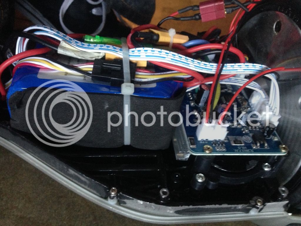

In response to you recommendation for taking photos, here they are. I unscrewed half of the hoverboard exposing the battery. Although I still have my doubts on whether this is genuine or not, I'm at least glad there was an attempt on showing a Samsung battery. I wouldn't really know for certain unless I ripped it open to see the cells. Didn't go that far.
My intention for opening this up was simply to see if there was an obvious BMS and to confirm that the battery wasn't visibly swelling like I've seen my other Lipo batteries do before.
Maybe I'm just easily impressed, but it looks like they did a clean job of putting this together. The zipties were clean and the connectors appeared to be decent quality.
Do you see a BMS? Any comments regarding these photos?
Yeah, it doesn't exactly look thrown together. Can you tell if the battery is can or pouch cells? If it's made of 18650 can cells, Samsung or not, that's a good sign. I think if there's a BMS it's part of the battery. If you can get the battery out you may be able to get a peak at it under the blue shrink wrap if its there.
From all the photos I've seen of these things, they're can cells. I was told the BMS might be built into the board rather than into the battery like we typically see in electric bike battery applications. Not sure. Little worried about rupturing anything and/or not being able to get everything back together nicely.
Over the weekend, I bought an ABC rated fire extinguisher! The things we go through to ride a risky device. Ugh.
I was looking before to see if the BMS was integrated into one of the motor controller boards, but this would require a set of balance wires joining the two, which didn't seem to be present.
