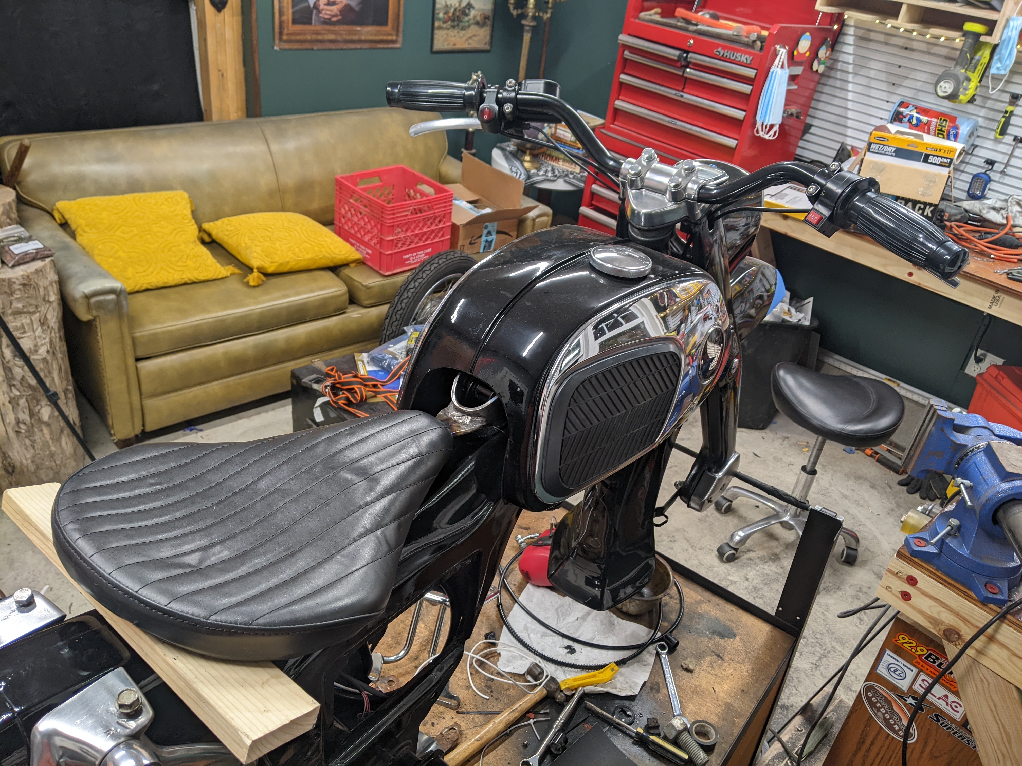

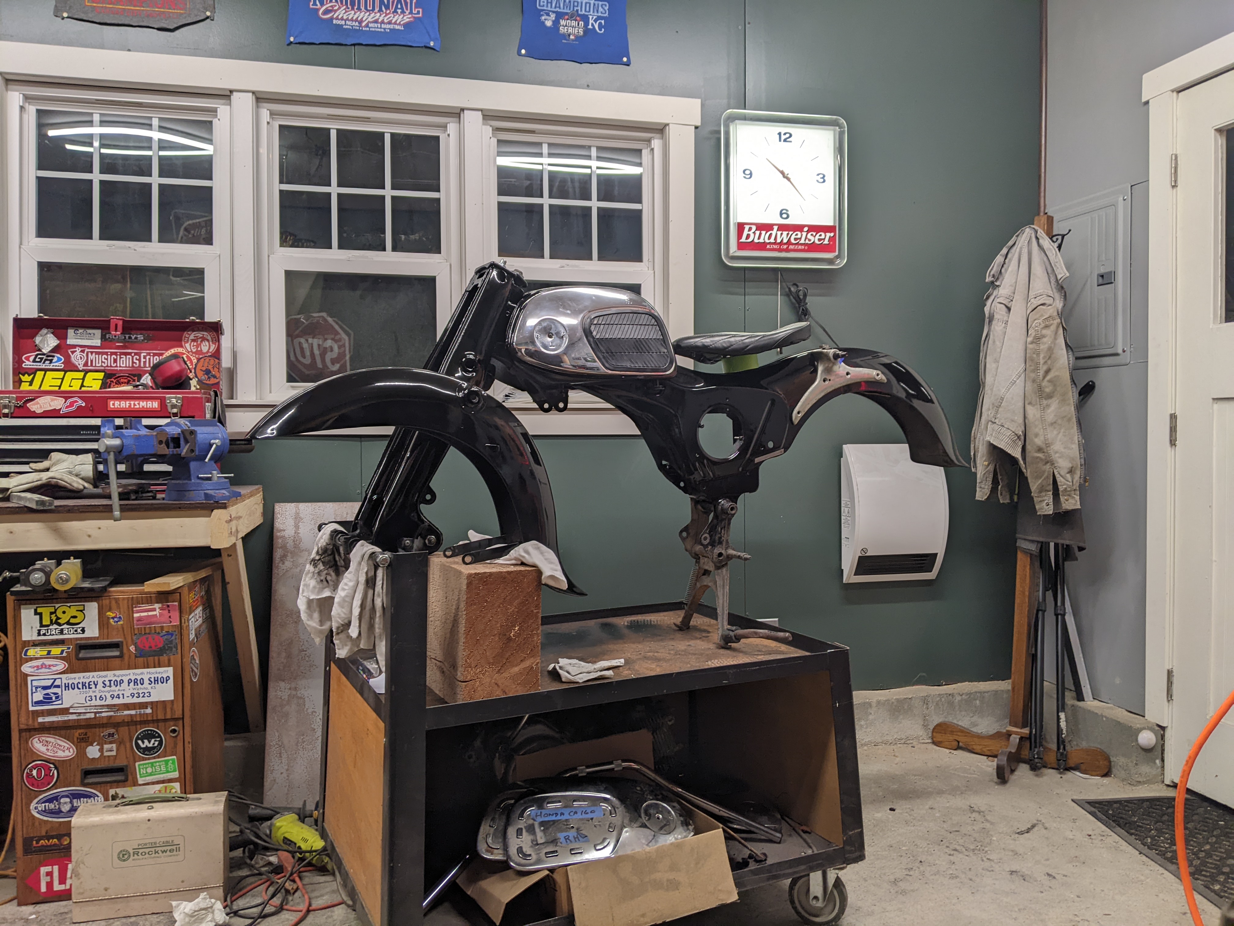

I needed to reinforce that lower-right corner of the frame. so i boxed it in with the other side. Originally there was a carb and air-box in that space, but that is no longer needed.
Now that i had the motor controller mounted, I moved on to mounting the dc-to-dc converter. I cut a hole on the inside section of the gas tank, and it fits inside the tank now. Perfect.
I also picked up this solo seat at a swap meet last weekend. Im not 100% sure i will use it but i will keep it for this project for now.
