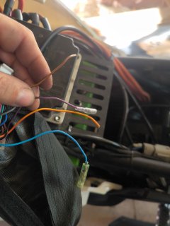

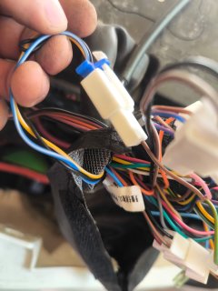

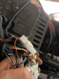

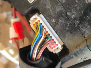

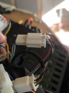

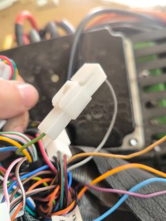

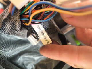

Hello,
I finally had a chance to take another look at the FarDriver controller, and I'm afraid there is no connector for the Bluetooth dongle. I've attached photos of the tag attached to one of the wires, as well as every connector plugged into the controller. I think the wiring is done really terribly. There are even four wires that don't go anywhere at all – they are simply left with free ends and are not connected to anything. The red connector visible in one of the photos has only three pins populated, and I believe it is connected to the alarm system.
Is there any other way to connect to the controller and access its settings?

On some Controllers the plug is missing.
You can buy a complete wiring harness from aliexpress or from Sisecosys. But I do not know if the plug for the Bluetooth is internally connected in your Controller.
Is there no wiring diagrams available for this controller? You don't need Bluetooth to connect, you can use an adapter to the computer instead.
