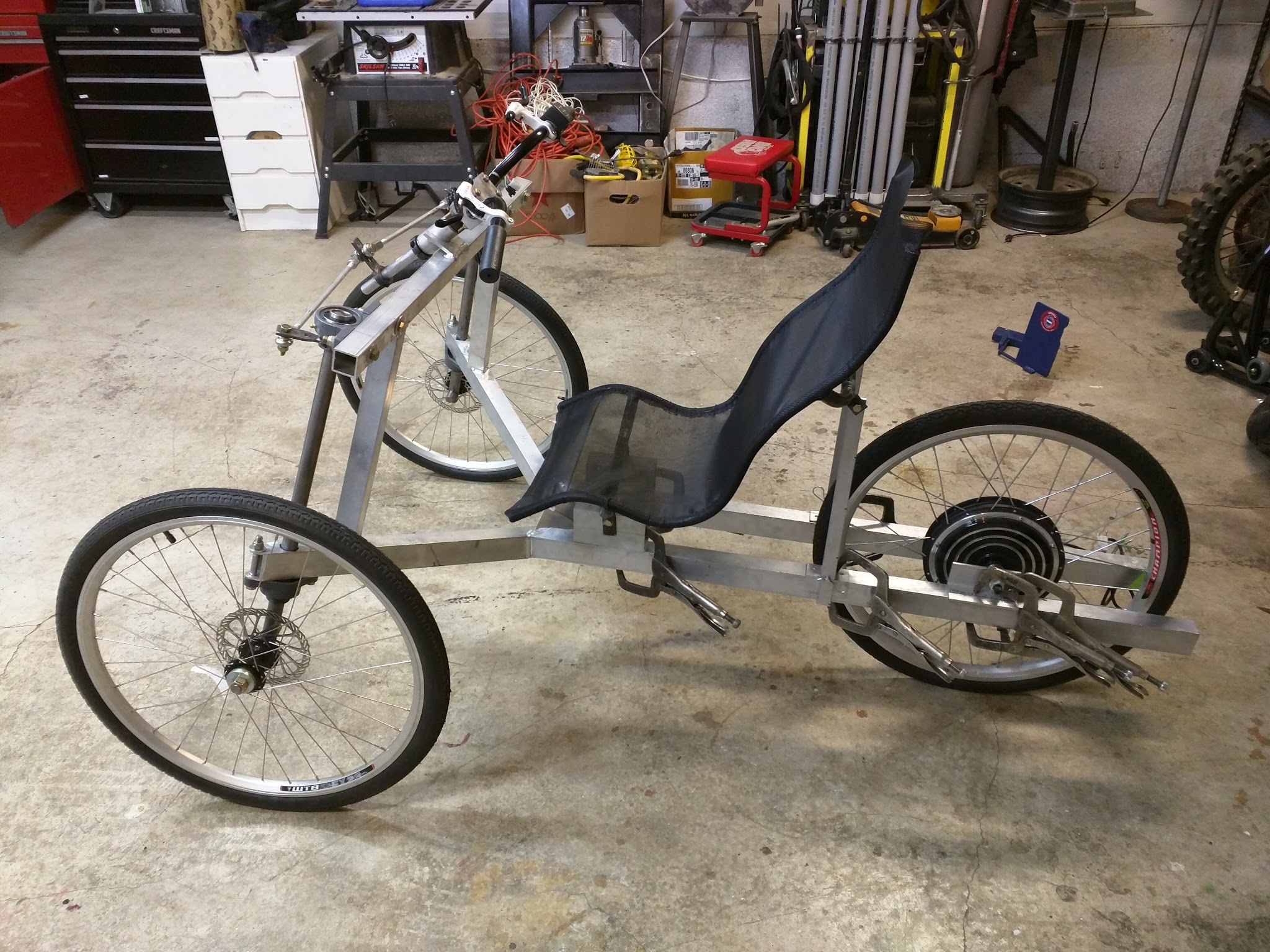

A while back I decided I wanted to turn a motorcycle into an EV bike. After internet sleuthing I came to the conclusion that wind resistance at highway speeds makes for some expensive battery/motor/controller combinations, and my motorcycle already gets 50mpg+. So I decided to build an electric bike. But then I moved to the pacific northwest and the need for a roof over my head came. I decided with a roof I need another wheel. So I started designing. Internet searches returned velomobiles, which I think are cool, but I feel like their low profile is asking for trouble in traffic, flag on a pole or not. It needed to be lightweight, easy to sit down in, low rolling resistance, and as little aerodynamic drag as possible despite electing to not make a low profile layback velomobile. Above all it needed to be practical. This is what I came up with :
I know you're thinking "That's an ELF!" Well, I hadn't seen the ELF until I was already welding the frame together from a 3d model I made when I came across it on YouTube. When I try to think of a strong design that works with aluminum and remains as light as possible, this is all I can come up with. That's my story and I'm sticking to it. However, looking at their design since then has influenced some of my own design decisions.
I elected the make the prototype as cheap as possible without skimping too much on quality. I've put quite a bit of money in it despite that. Some parts such as the pillow blocks and flange bearings are going to be swapped out with machined and welded in stem tubes for pressed in taper bearings for the lower bearings and bushings for the upper supports to save weight once I've proven the design to myself and done a little testing. I had the heavy bearings laying around already. No pedaling components until after testing.
I've got pretty much everything figured out except for the body. Not a clue on that yet. however the skeleton will provide trussing for the main frame. It'll tie in much the same as the ELF's does and the storage above the tire is an idea I will certainly steal.
I work on it every day so I'll keep you guys updated with pictures. Feel free to share your ideas and ask questions. I might skip putting the brakes on and do the wiring this weekend and take it for a spin.

Rode it today at 48v. Pretty impressive speeds. Crawled up a steep hill at 5 mph. 1000w would be enough with light pedal assistance for even the steepest hills. 1500w 72v will be perfect. Need to lower the seat as much as possible. Was putting it on 2 wheels with fast, sharp turns
That sounds awesome! I have a home-made electric scooter (the one in my profile pic) with 48v 1000W hub motor that looks similar to yours. 20" wheel. We have a steep hill here I tested it on and it easily does 30km/h (18mph) without a problem. It doesn't have pedals. Your hill must have been pretty steep!
Looks like tons of fun :) That has a ton of acceleration. 72v would have you pulling wheel spins!
Question: why did you build all that camber into your front wheels? Almost all the reading I've done so far in to recumbent trikes keeps the wheels as vertical as possible, or perhaps a tiny bit of camber. I'm very curious!
When I was designing it my idea was that the outside wheel when you're cornering needs to be cambered to keep from folding. When you're cornering really hard you can hear that outside Tire really work working.

Rad! What's the body progress? After I swap out the lower bearing flange for a machined and welded in bearing stem I'll buy myself a good bit of room to drop the frame as the spokes nearly scrub the flange bearing currently. Sure is nice owning a lathe :D lowering the rear end is as simple as slotting a taller piece of aluminum angle for the rear axle to slip in but also raises the chain path. Trying to avoid the weight of idlers or jackshaft
Do you have any plans to add suspension? I would recommend it. My recumbent with suspension is a lot more comfortable than any un-suspended bike I've ever ridden. I could literally ride for hours and not get fatigued, versus an upright bike.
If there is going to be a suspension it'll probably be rubber donut bushings under the lower bearings and a flange welded onto the kingpin. I find 26" wheels very smooth across the bumps. It's a commuter
