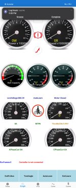

I'm in need of help, my bike ran until I strapped all the wiring down, I Also, touched the positive lead on the controller with my hand and the bike frame and it shocked me. And I did something in settings that stopped letting me connect and bind to the app, it now beeps 5 short beeps, one long beep, I can't connect to the app to change whatever setting I messed up, trying to find a way of factory resetting the controller without the app somehow, please help
