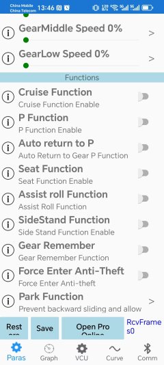

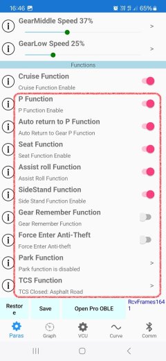

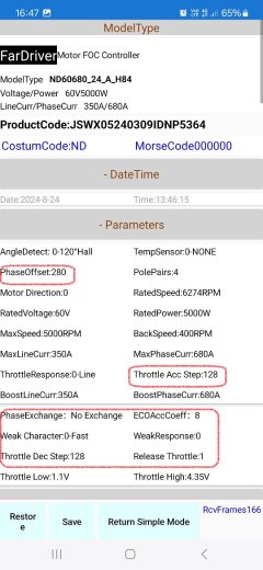

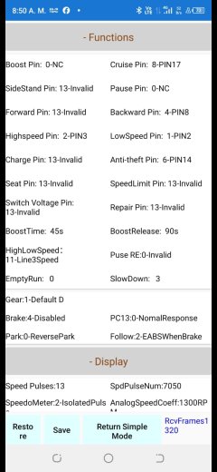

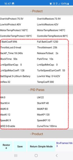

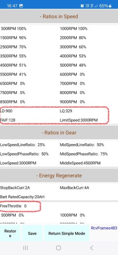

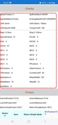

Hi, sorry if I missed this information somewhere in the thread, but is there a comprehensive documentation available for Fardriver controller settings? Particularly interested in the values highlighted in the attached screenshots. Thanks!

Hi

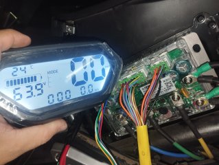

If anyone can share their display settings in the fardriver for getting the dkd one lin display working would be great. I've apparently got it wired properly, it's only power and one wire but it does not read any speed or other info. Put oscilloscope on it, looks like it's sending something so figure my settings must be wrong.

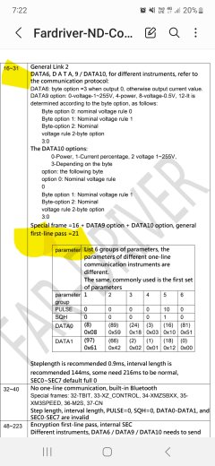

What does the "SpecialFrame" parameter do and why did you change it?
Sorry if I missed this one but did you get an answer? Mine was at 0 by default, updated to 21 and now my display started working.
Does anyone know how to determine the correct value for speed pulse number?
Okay so I found it here in the manual.
To get speedo to work accurately I had to set speed pulse to 1.
I had assumed it would be as per the number of poles but it seems not.

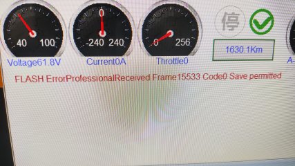

Hey, everybody! Need some help. Fardriver 72680, was riding, the bike switched off, after restarting went, but , phase current and boost became 100a, and does not change towards increase, factory reset does not work, and there is such an error:
There is no PAS in the app and I never heared from it.

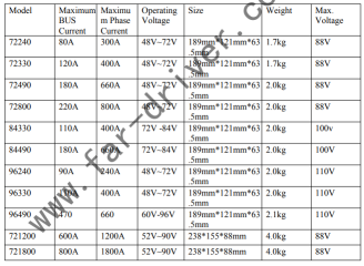

Quick question about FarDriver controllers, I've read that a ND96 series (96680 for example) could be used with a 72v batterie by changing the parameter if needed. Is that true ? Is the opposite also true ? Using a ND72680 and change its parameters to 96v if you want to upgrade your batterie ?
Hiya,
My reading of the Far Driver manual the ND72 (or ND??) is the maximum voltage which they recommend/support. So I think you might be out of luck trying to push a 72v to 96v.
Two years ago I bought from Siaecosys an ND96850 which was internally locked to 88.5V and had the same values as an ND72850.
I got an upgrade firmware and with that I could raise the upper voltage limt to around 120V and I have also tested these new voltage levels without damaging the controller.
Last year I bought an ND72680 from Siaecosys where I can change upper und lower voltage levels, but only up to 88.5V
I bought also an used ND721800 , I do not know how old it is, maybe two or three years old. There I can not lower the upper voltage limit.
This year I bought an ND72450 from Siaecosys, which does not let me change the upper voltage limit.
So there are different hardware/software versions out there.
An ND96 will definitly work with 72V, probabaly you can not set the limits in the controller to fit your 72V nominal voltage, but that does not matter while using the controller.
Changing the upper voltage level via firmware (make a 96V controller from a 72V version) without the matching internal components may result in a damaged controller.
Higher voltage rated components are more expensive and I think they use different components for different voltage levels.
Hello. I am new to the Fardriver controller and I have recently purchased one and after the self-study, when it comes out the motor vibrates and another thing that I was also looking at is that it does not allow you to modify the Ki or KP value. Can someone help me?
Try to adjust LM,
Motor acceleration matching parameters, this value is used to adjust the smoothness of motor operation.
The default setting for cars is 22, and for electric motorcycles it is 18.
Some small power tricycles are more suitable for sizes below 10.
However, there are some motor types that are poorly matched with the entire vehicle, and noticeable resonance vibrations can be felt when starting at low and medium speeds.
Adjusting the LM value will improve Starting from 22, if there is acceleration jitter in the low-speed range, reduce LM. Test the effect from 16, 14, 12, 11, 8, and 5, and the numbers in the middle will also take effect. Generally, it is better to choose a larger value than a smaller one. Too small can cause uncontrollable current, leading to MOE/OVER protection and even burn control. So when the jitter disappears, the LM value is the optimal parameter and should not be further reduced.
Some motors and vehicles are very smooth at LM=22, but reducing them may cause vibration. Therefore, it is important to note that if there is no problem at LM=22, this parameter should not be adjusted. Or after discovering the occurrence of jitter resonance, the LM value decreases from 22 to 16, 14,... If even 5 doesn't have much effect, it means it has nothing to do with this parameter. At this point, it is necessary to return to the maximum value, such as 22, instead of keeping any number in the controller.

Your throttle dec step is too high, causing a return current that is too high, try changing the value to 70
