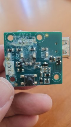

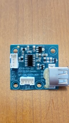

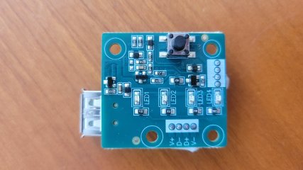

Hello! New to the forum here and appreciate your help in getting my battery back working again. I recently acquired a Blix Packa Genie (2 battery version), and the downtube battery (battery model Reention Dorado Plus, 48V/ 14AH) doesn't turn on. The previous owner left the bike out in a rainstorm and said after that the LEDs on the battery would momentarily light up when the power button was pressed, but the battery wouldn't turn on. At this point the LEDs no longer light up at all.
I opened the battery and check the fuses which are both good. The small board which contains the power button, LEDs, and USB charger port was heavily corroded and so I cleaned it using DeOxit. (See photos). However, upon re-installation of the board, the battery still does not turn on. What is helpful, though, is that the board has good labeling so I can see what each wire coming off the BMS does. One set of wires is labeled B-, P-, KEY, and B+. The other set of wires are labeled V-, D+, D-, and V+ (I know these to be the connections to the 5V USB port on the battery shell).
