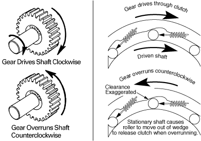

Oh, and by the way, the VXB chat gal informs me that, at least in their parlance, a "Clutch bearing" is a needle bearing; a "Sprag bearing" is a roller bearings

Regardless of the style, a clutch bearing rolls in one direction, and locks in the other. A "spag" is a specific type of rocking element inside a clutch bearing:
Sprag: http://www.youtube.com/watch?feature=player_detailpage&v=Fsp3fm4KHs0#t=50
Trapped roller: http://www.youtube.com/watch?feature=player_detailpage&v=QjR7dimpSJA#t=44
Remember the "one way bearing is actually being used as a clutch and is subject to the full torque of the motor. So a press fit is not likely to hold. There are some very strong Loctite products that may work though. You can also check the thickness of the outer shell. If thick enough you can have the machine shop grind a few slots (maybe 4) the length of the outer shell with matching groves in the inner bore of the new gear. Then Loctite in 4 steel or brass pins. This is a common process called "dog pinning". It's normally done on the surface of gear sets and set screws are inserted into the drilled/tapped holes. That way you just remove the set screws to remove the inner part.
