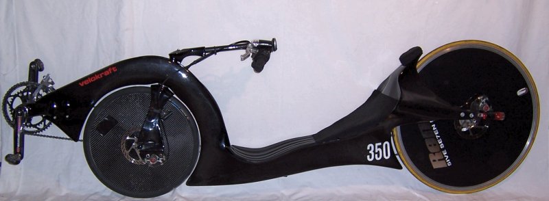

[The hour record for recumbent bicycles without aerodynamic fairings, set by Francis Faure in 1933, was broken in 2007 by Sean Costin, who covered 48.80 km (28.46 mi) on the 382m outdoor concrete velodrome in Northbrook, Illinois. Costin then rode 47.89 km (29.76 mi) on the 250m indoor wooden velodrome at the ADT Event Center in California. He rode a recumbent made by the Polish manufacturer Velokraft (model name NoCom), which he converted to a fixed-gear for the indoor event.]
Here is an awesome electric assist also built by Kamil Manecki of VeloKraft.

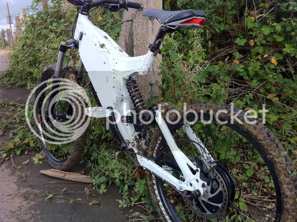

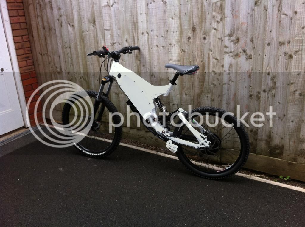

OK having read thru the whole awesomeness of this discussion I’ve decided to jump on the Bandwagon and ordered a 750W drive from AliExpress. My plan is to upgrade/de-Frock my Mac powered Big-Hit FSR which I built a couple of years ago for off-road use. I really like the idea of eliminating the unsprung weight from the rear wheel. However before removing the Mac, I intend to have a bit of fun with both motors installed on the bike.
I recall someone saying the Bafang wouldn’t fit ‘most Specialised full sussers’ but apart from grinding down the ISCG mounting and omitting a lock ring for the wider BB, it looks like it should fit this frame so fingers crossed.
Billsy,
I recently mounted a 750W Bafang on my Big Hit. I had to remove a very small piece of aluminum that held on the chain guide from the frame. I also had to very slightly remove some material at the end of the BB threads on each side. The motor then fit great and sat up higher than the chainring. The bike went 32 mph at full throttle and 25 mph when peddling.

Thanks for the info on the Big Hit. Are you saying you had to remove some material from each face of the BB i.e. make the shell narrower? How much did you need to remove and why? Edit. You got any pictures?
I’m well impressed with the top speed you are reporting, that’s plenty fast enough for my local trails!
Real shame about your battery. That amount of sag is going to kill it rather quickly. Have you thought about assembling your own pack? I’ve got 16 x 12ah headways in my frame with a Ping high rate BMS, dead easy.  Failing that, have a chat with cell_man (paul) he’ll sort you out.
Is the face that butts up against the BB recessed around where the BB outer face meets it? On the pictures of the 350w it looks like it is flush, but the 750w seems to look like there is a recessed ring around it. In other words (ignoring the rest of the drive interfering) if there was a BB diameter hole in a flat plane would it mount properly?
There is a small recess in the gearbox housing. I used a freewheel / bb cup spacer so it would mount flush as my bb face is flush with the adjacent swing mount. It was around 1.5 mm thick and it tightened up nice and square with it.
Your Big-Hit is an awesome bike. You are going to love it even more with the middrive. I really hope you can get the chainline spot on as this will be the difference between it being good and being great.
