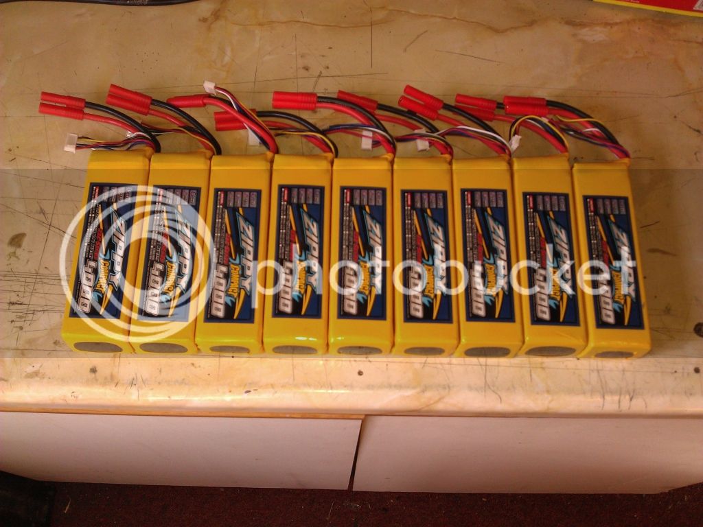

I have built my own battery pack before. I used nine zippy's mounted in a custom frame job on a Giant DH comp. The dam thing caught on fire and nearly took my workshop down. I had over 1000 miles on that bike before it burnt up. I'm trying to take a safer path now. That is why I want to pull the battery out, and put in my outdoor grill to charge from now on.

I was coming round to the idea of using lipo. Now you just convinced me to stick with LiFe!! I just plug my commuter in every night and forget about it. 4500 miles so far.

Yes the bike caught on fire while charging. The charger was purchased through BMS battery. I was balancing them, then bulk charging. Here are some pics of what the bike looked like and damage. I'm happy to save someone else that hassle I went through.
This bike did 50mph with a range of 30 miles. I really loved it, and plan to rebuild it someday soon.
I only charged the bike when I was home, so I caught the fire before it took the entire building down and put it out with a garden hose.

Whoa, that is terrifying! Glad things were no worse than they were!

No worries about using Lipos? Especially considering what happened to Chalz (and many others)?
