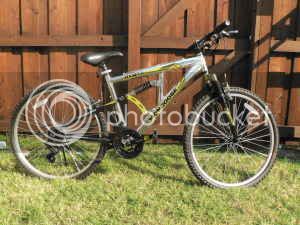

I picked up a full suspension bike for cheap last night. Realy all I want was a base for building a full suspension road bike. Too much time on a hard tail, and too much time stairing at Full suspension Motobecanes got to me.
But this cheap Toys R Us bike will need a full rebuild before it can handle even the power I can put through it peddaling. it may end up being nothing more than a template for a whole new bike.
So is there someplace were I can buy premade bike aprts, like headsets, crank journals, and dropouts?
My plans right now are to build it to accept the 700c wheels from my roadbike, and build the battery bag and controller to be quick swappable betwween the bikes.

Fixing a cheap bike will nickle and dime you to death, better off finding a good deal on a ready-to-go bike and using the free bike for parts !
ypedal is right - you are better of finding a slighly used fs bike on ebay for a couple hundred bucks. By the time you source and purchase all of the parts required to modify the TRU bike, you will have spent the same amount, maybe more.
If you intend on using 700c road wheels, you are better of finding a 29er full suspension frame - this is an mtb frame with geometry designed around wheels with the same diameter as road wheels.
but then you will be into more money, as most are only disc brake, so you can't use your wheels, so you buy more wheels, and brakes, and etc, etc,etc.
been through it many times. better off bleeding all at once, rather than a little for a long period of time....

So after some re-examining of the project, I decided there was no way to make the cheap full suspension bike work. the frame was just too light weight. It'll make a good gift for some needy kid this Christmas.
What I did decide was to go with a conventional triangulated frame full suspension bike, and eventualy found this:
I know, its a Mongoose. another cheap department store bike. But the frame is solid and will accept my 29 inch front suspension fork, all of my good running gear, my shock absorber seat post, and Handlebars. I'll only need to modify the back suspension to take the 29 inch size back wheel instead of the 26, as well as give me the wheelbase I want ... and ditch the yellow paint and stickers. The wiring will be all in the back anyway so it can be hidden when I modify the suspension
That leave only one part I need to find. The rear dropouts. I can fabricate just about any suspension part I'll need, but a dropout would actually be a very complicated part to make from scratch, without it looking like it was built by a redneck. I also want a couple of beefy ones that won't need a torque arm to handle upto a 5305.
Anyone know where I would go to look for a pre-made dropout?
