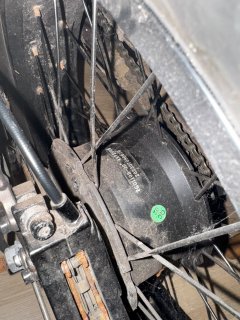

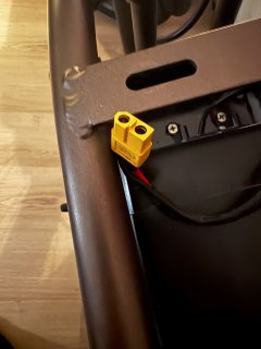

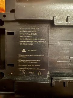

Hi everyone,
I’ve decided to replace the controller and display on my e-bike, as my current setup isn’t working anymore. I would love to hear your recommendations for a compatible controller and display system that supports my bike’s hubmotor and battery and offers a discreet way to switch speed limits for European regulations.
My E-Bike Specifications:​
- Battery: 48V 18.2AH with an XT60 connector.
- Motor: 750W hub motor (marked 250W due to European regulations).
- Existing wiring harness: I would prefer to reuse my current wiring harness if possible.
What I’m Looking For:​
  1. A reliable controller that works with a 48V, 750W motor and is compatible with an XT60 battery connection.
  2. A display that pairs well with the controller and offers a clean, easy-to-use interface.
  3. A quick and discreet speed limit toggle (e.g., 25 km/h / 15 mph for legal compliance, and higher speeds when toggled). This feature should not be obviously visible to avoid issues with European regulations.
  4. If possible, a plug-and-play setup that works with my current wiring harness (details and pictures of my connectors are attached).
Attachments:​
I’ve included pictures of all my current connectors for reference to make compatibility easier to determine.
I've added these pictures:
the battery connector
hubmotor type
motor connector: the 3 pin connector or 3pin to the yellow blue green white motor cable extension cable
current (broken controller)
both ends of the wiring harness
current battery specs
Thanks in advance for your suggestions! I’m looking forward to hearing about systems that have worked well for you. :)
There's a fair likelihood that you'll have to put an XT60 on the new controller to match your battery's polarity / wiring--it's not uncommon, but not the most typical connector to see on them (some come without any at all).

The left side shows the motor cable unplugged? The right side is the end of the cable that would have plugged into the motor?
Very odd combo for your controller wires. First, the motor connector is a high power connector I've never seen before, but it does terminate in a old fashioned 3 bullets and square Hall plug at the controller, However, I've never seen controllers that use the old fashioned motor connector with a 4n1 or 5n1 handlebar harness cable. Maybe others have seen these.
You can buy a KT Sinewave controller, either 22A or 25A with waterproof connectors like this one, . Then you need this 9 pin motor cable adapter to connect ro your motoe cable, It might be too long. Also a new KT display,
