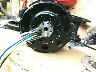

I started on the frame :) I did not build a jig so I'm a little concerned by getting evrything well lined... I will probably end up using this frame as a prototype, to ride this summer and to build a jig for next ones if the concept proves sucessfull (I hope so!)
I finnaly went for a mid driven 9c front as a single speed. The high efficiency mini monster from John in CR would have been great, with its Kv of 17 and small diameter, but it was a bit too wide and heavy for this project. At 340€ delivered it was decentely priced but i'm just a student :roll: . The 9c option was less than half that price, meaning that I will have some fund for stuff like good suspention components or brakes :)
I will run 20s lipo and reconfigure the motor in delta if I can to get a higher Kv. The motor will power the rear wheel trougth a 14t velo-solo disc mounted sproket, with BMX chain and a 17" pit bike rear wheel. I plan to run 80A peak, so about 6kw, geared for 55-60kph. Gearing changes will be as simple as bolting another cog in front, they make them up to 24t!

Hi Adam,
I currently have front used 9C 2806 front and I'm asking 80$ + shipping I need to put the cover back on the motor because I have open it. But I don't know how it cost to ship this motor to you, pm me if your interested because I will put this motor in a week or two on the sale trade. Since that I'm using a Cromotor this summer I didn't need this motor any longer.
