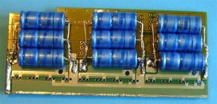

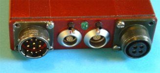

For fun I am building my own controller for any sensored BLDC motor, using the Crystalyte 408 to start with. The PCB arrived today, I want reliabilty so a home made PTH (soldered through) board was out, so I spent some money on a pro job.
I intend to implement phase advance with this, I will let you all know how it goes. For the techies, two dsPIC30F2010's do the work, one could do it all but keeping the motor algorithums seperate from the rest makes programming easier. If I was to make 1000's I would fit it all in one chip but for now...
When (oh optimist) sucessful I will publish the design here.
So without further ado, some pics with explanations.

I'm sure you'll have a lot of interest in this! Looks like a very rugged and durable design. MIL connecters right on the box look the business 8)

Those electro's on the rear of the pcb will ultimately need vibration damping, eventually the pigtails will fracture.

Some replies,
Board, circuit and board designed by me, board manufactured by TopTec
FETs IRF2907s (6) with 100V 40A shottkey diodes in //ell
Supposed to fit 100 0805 caps, bugger!
Big caps will be held by a bit of foam (I used to design Mil stuff, very aware of vibration effects)
Max volts, near 70V (the diodes and 0805s help in reducing spkes)
Max amps, I am being very conservatve with 20A per batery, 40A total, with a maximum 70A to the motor.
To limit the maximum current elegantly I am going to use the speed to calculate max PWM allowable on the fly.

IR21834s, seem nice and bullet proof, you can do a lot of damage in unconstrianed software. These have 'shoot through' prevention, FETs would get killed, even these big ones, if I turned the top and bottom on together combined with the VERY low ESR of the 9.9uF ceramic capacitor.
And my engineering brain likes the seperate common (FETs) and 0V (logic) connexions.
Other points of interest, Logic running at 3V3 and the supply to my controller 8V, both these rails derrived from the 12V FET drive voltage via linear regs. 12V supplied by an LM5007. The 350mA current source for illumination LEDs also done with an LM5007. Slow turn on done with an FET switch (saves the 'crack' of charging the caps), this is then shorted by a big (70A) relay for running.
