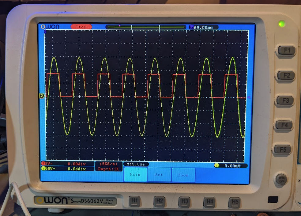

QS165 motor magentic encoder with hall output
An encoder retrofit for the QS165 motor
This encoder is designed as a drop in replacement to the QS165 motor and uses an AS5047 to generate Hall output. In order for this to work you'll need to program the AS5047 with an external CPU. So basically this is unnecessarily expensive requiring purchase of a custum PCB and a teensy to program the board. It is unnecessarily complicated in that it requires a custom programmer dongle, common bench testing equipment, assembling a board, and knowledge of programming.
On the other hand I'm not aware of a lot of alternatives.
github repo is here.
Acknowledgement:
  • David Molony kindly helped with some development of early boards.
To build board and test
  • Create the programming dongle shown below
  • Select between 3.3V versus 5V operation with solder jumper
onnect up up the finished PCB on the bench or motor
  • Confirm the initial outputs of the AS5047 with an oscilloscope
Programming
The 5047 uses one time progromming to change some of it's registers permanantly. Note that programming definitely means you get one time to program the chip -- so be careful
As CircularBuffer points out, that code will probably work on a number of platforms. This works for me:
  • Review main.ino carefully to understand how variables are sent to the AS5047 and the program flow
  • Default variables for QS165 are set in main.ino using the lines:
Code:
  AS5047P_SetFieldInRegister(&encInstanceA, AS5047P_SETTINGS1, AS5047P_SETTINGS1_PWMON, 1);
  AS5047P_SetFieldInRegister(&encInstanceA, AS5047P_SETTINGS1, AS5047P_SETTINGS1_UVW_ABI, 1);
  AS5047P_SetFieldInRegister(&encInstanceA, AS5047P_SETTINGS2, AS5047P_SETTINGS2_UVWPP, 6);
Note: the QS165 has 7 polepairs, and according to the AS5047 docs you pass it a '6'.
  • Salt to taste if you have something else
  • Load code on teensy board using the platformio environment to install code
  • Once programmed, connect teensy to encoder board using programming-dongle
  • Start up a serial terminal
  • While program is running, review the program is effectively communicating with the encoder board
  • Confirm you like the actual output of the pins on encoder board
  • Entering single characters into the serial input gets ready for the burn
  • Typing anything besides "x" shows you serial input is working
  • Enter "x" when youre ready to burn
  • main.ino will report "no errors received, test if burn complete" if it worked
Programming hardware
An example of programming a earlier version of the encoder board with a teensy 3.6, ribbon cable and 6 pin connector.
Pogo pins may be helpful for making quick connections to the board.
Output
Oscilloscope output showing a single hall channel switching synchronously with one of the QS165's phase wires.
