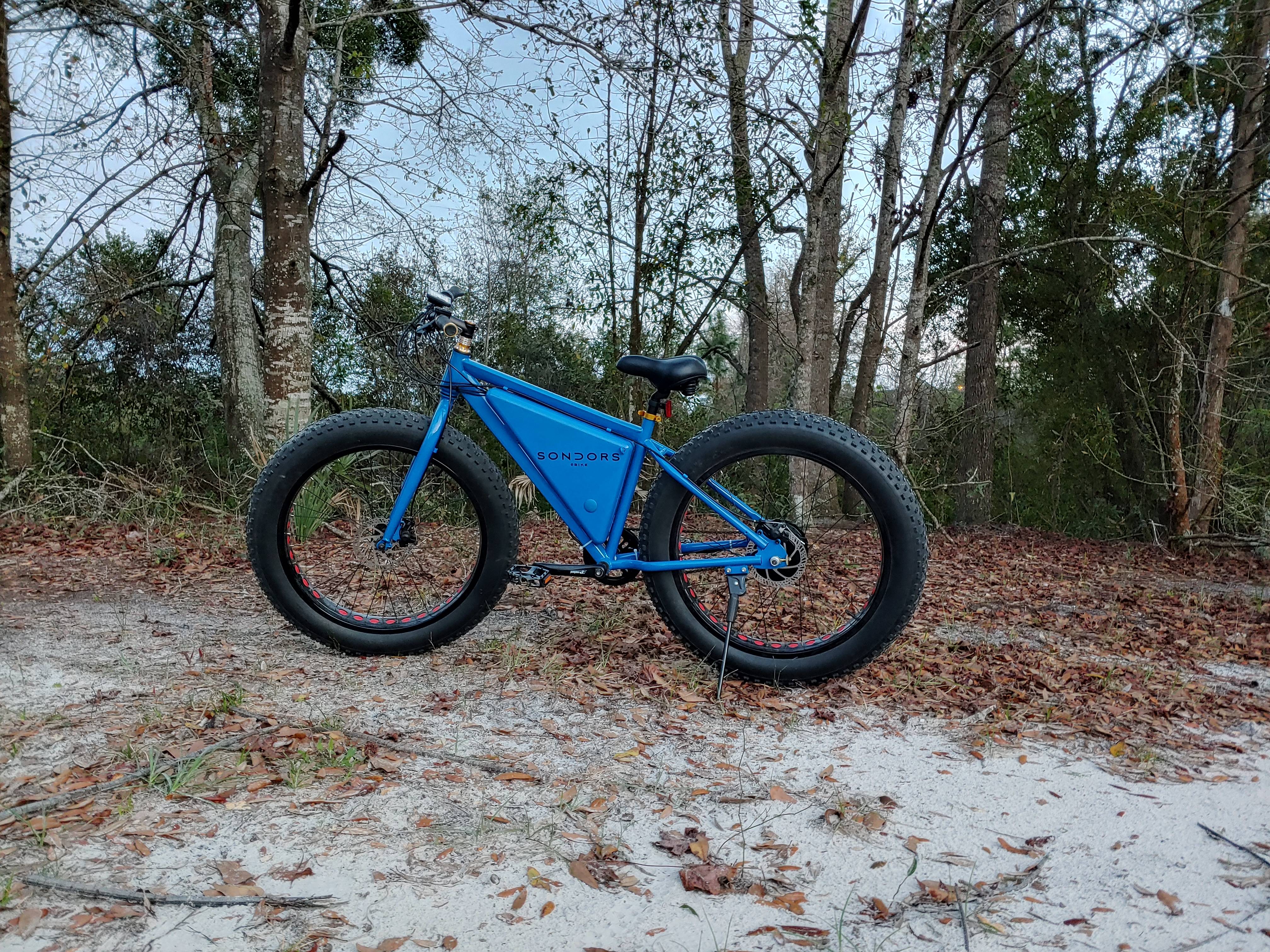

Next up is the good news. I got everything connected on my "blue bike" and went for a ride! Wow, so much better than the stock setup (prob 3x power), although I did expect that its pretty much what I wanted, so very happy with this setup now. When I could briefly look down at the LCD I noticed over 1500w at times so i think its working pretty good, not sure if I can get more out of this setup, lol.
My MPH is still a little off but I think that should be something in the P settings I can play with and get right.
Blue bike battery box: (is the foam safe? I rode it rather hard for a while and it never got hot that I could tell touching it)
Two pics of a local site I just rode to today for a quick ride. I do have a few misc things to still fix on this so will work on that and post if needed... Thanks for all the help guys, hopefully a new LCD will fix that and I will reply back once I have an update...
