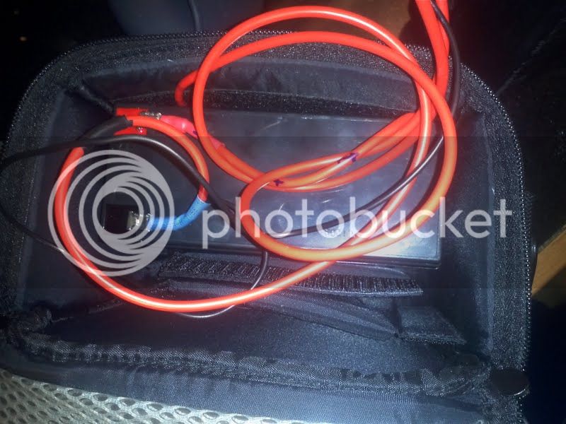

I ordered that exact same controller you listed and the currie 36v throttle to go with it. It all was plug and play. The overcharge protection plug does not need to be plugged in for the controller to work fyi. I added a third 10ah 12v battery for $23 i got off ebay and a 36v currie charger for $14. All together the 36v conversion cost about $90 and its definitely worth it. Speed is much better! Ill see what the range is like tomorrow.
I used an old camera bag I had laying around for the third battery. It fits perfectly! I had to bypass the stock fuse so I gotta pick up and inline fuse holder form the auto parts store tomorrow.
