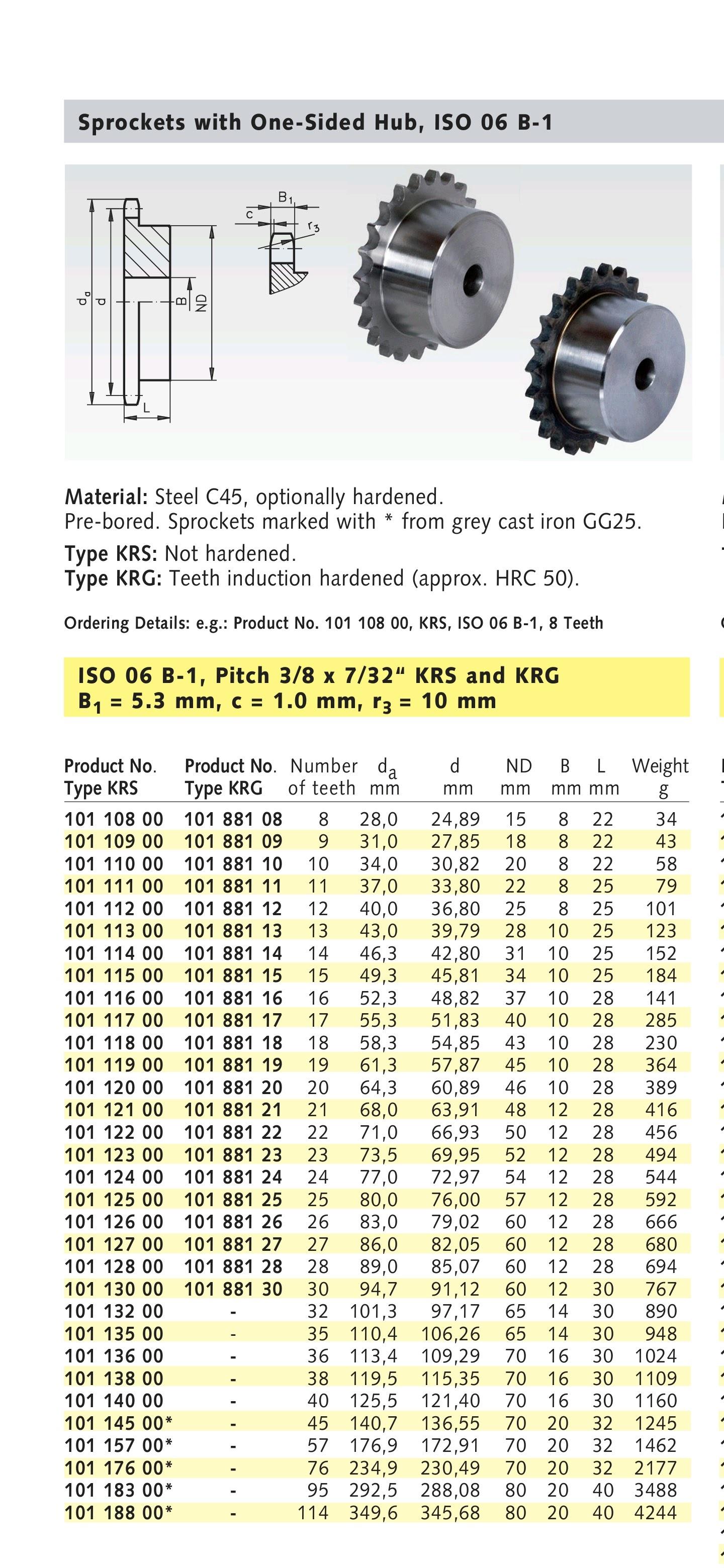

Im building custom gear, spider and sprockets for the TSDZ2. I was not happy with the current centerline and thin sprockets.
Maedler sprockets
Front 54t
Back 28t
Spider Alu 6076T6

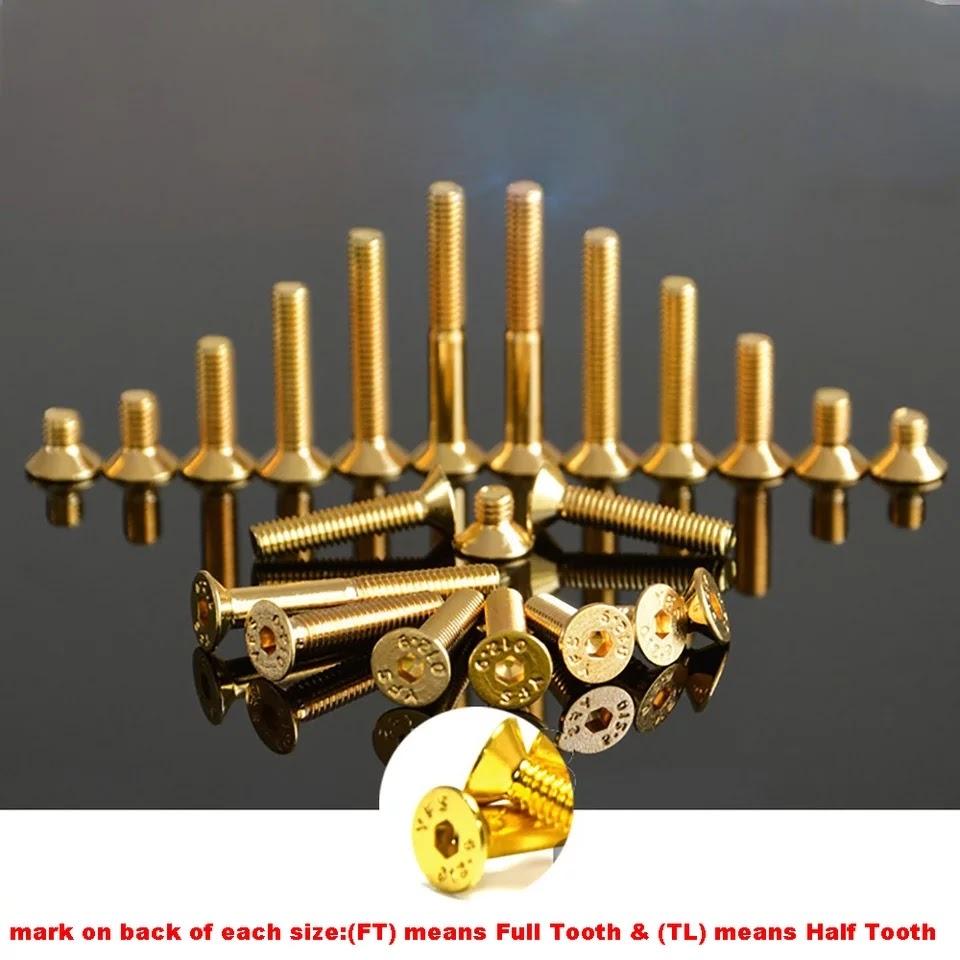

40 M2 screws fasten the spider to the sprocket

Sprocket
Maedler

M2 screws 12.9 Ti Gold platen CS Hex
