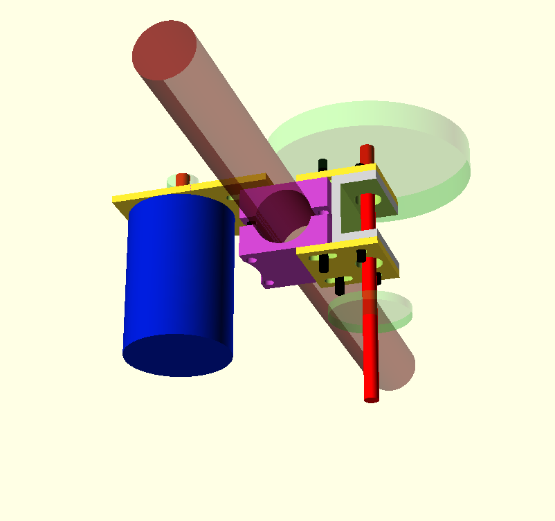

Designed a first version of my flip flop hub drive
eTim
Apr 20, 2017
16
Utrecht, the Netherlands
...and I've never done anything like this before, so I would love to get some feedback! About a month ago I started seriously working on my ebike project that I've had the idea for since I first got my flip flop hub bike. Basically, and I'm sure it's been done before, is to use the unused sprocket on the left side of the hub to power my bicycle. I specifically want to make everything myself, because that's the challenge and the fun of it. Let's get on to my idea for the drive.
This is the current version 1.0. In the image the motor is mounted on the right and the reduction shaft is on the left, driven by a large gear wheel. (I'm sure this is not entirely to scale, but I did make the frame tube the same diameter and tried to line it up as best I can)
It would be a belt driven system from the motor to the trough shaft, and from there chain drive to the rear sprocket. Currently I'm planning on a 6:1 ratio on the belt drive and a 42 tooth rear sprocket, with easily swapped sprockets on the trough shaft :wink: So a lot like the recumpence drive, I guess, but then self made.
Some context: the motor is blue, it's shaft is red, the yellow plates are, well, plates, the red tube is the bycicle frame tube, the green wheels are the gear wheels, the grey U shape is the trough shaft mount, this would house bearings to hold the trough shaft of the reduction drive and finally the black tubes are temporarily there to show screw positions and how far they go into the material.
In this image here you can see the motor with it's shaft position in the mount, and the pulleys which are a bit transparent.
I tried to make multiple parts to keep cost down, the yellow plates could be laser cut, leaving only the tube mounts and trough shaft mount to be CNC'd, plus it leaves more adjustability.
This is a more side view of the assembly. I'm not sure about the 'screw pattern'(?) I want to use. On the left side of the frame tube I want to make the top frame mount holes without thread and only the bottom pink frame tube mount have threads. On the right side of the tube I will then mount both sides of the trough shaft plates on the tube mounts, leaving only the left side of the tube mounts to 'pivot/bend' to create a pressure fit on the frame. I'm not sure about this, what do you think of this?
Another idea I'm now thinking about is to make the trough shaft mount one piece, including the tube mount, moving the 'slot' between the two frame mounts to the (in this image) top and bottom of the frame tube, and fingle something out with the motor mount. This would mean I have less adjustability on the troughshaft though. Currently I have to adjust 4 screws for a single axis of adjustment though, and I'd like to add an idler pulley to the motor drive side, and I have no idea where to put it right now.
Here's another pic of the underside of the mount.
To give some context on the bike I'm going to build and how much power I'd be putting out: I have a SK3 6374 168kv motor, a self made 18650 6s5p 22.2v 14.5Ah 3c pack and I'm trying to go for range more then speed. If the tests are fine I'll build another identical battery pack and put them in series.
Let me know what you think! I prefer honesty, so if it's crap, let me know ;)

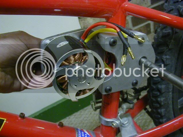

Here is something more simple ...
https://endless-sphere.com/forums/viewtopic.php?f=28&t=87390&p=1276322&hilit=Left+Side+Mid+Drive#p1276322
but I would do it a little different,
With your set up , just use a crank set with 2 chainrings on the left side . ( you do have the old fashioned square taper bottom bracket on your bike ? )
Use your RC motor , mounted to a custom , made by you mounting bracket then just run a chain down to the largest chainring on the left side crankset you put on, Remember
you can use a 50/52/53 tooth chainring, or even larger by buying a track chainring for the left side crank/chainring set. That way you will get a good reduction ratio, you will have to do the math to
find out exactly what reduction ratio, let us know when you do, as other people would also like make a simple mid-drive using a RC Motor.

I am still trying to figure out mid-drive systems and how to make them more simple,
So since I did not elaborate , here is my thinking,
You know how many / most if not all , of the mid drives have a freewheel build into/ designed into the right side/ normal drive side ... crank ?
Well instead of that , why not use a freewheel or clutch on the sprocket/cog that is connected to the shaft of the motor ?
That way when the motor is off or throttle not engaged , you can pedal as normal ?

spinningmagnets said:
You might draw some inspiration from these threads
"RC reduction simplified"
https://endless-sphere.com/forums/viewtopic.php?f=28&t=38213
"PaulD's Old Race Bike"
https://endless-sphere.com/forums/viewtopic.php?f=28&t=37729

Thanks so much! I've been browsing these forums a lot the last few weeks and time on time again I see you post stuff that helps a lot, thanks so much :) I also found this useful: http://www.recumbents.com/wisil/shumaker/default.htm
I've found a lot of inspiration in these forums, don't be surprised if I make a gear box at some point ;)
Thud's mounting solution really is a lot simpler, but lacks the adjustability I'd like, I'll go make a v2.0. Also from PaulD's build, I hand't thought at putting a bearing in the motor mount at all, that's a good one. I'll see if I can get away with that with the pulley width.

Version 2.0 for now:
I took a lot of inspiration from thud and pauld's builds that got linked. I like the mounting system a lot better now, each part has it's own screws to tighten it. Gonna see if I can figure something out for a pulley, because at my ratio (15:72) that undoubtedly will be a problem at some point
Yes, it's​ a good idea to limit your use of the 11 tooth sprocket on a cassette, to reduce wear and friction. But that's a cassette sprocket, which has short and narrow teeth to promote smooth shifting, on a pedal drive, which sees high intermittent torque peaks.
A motor sprocket usually has teeth that are full height and full width, so wear is less of an issue. The motor delivers torque more steadily, too. The one unavoidable drawback is that small sprockets mesh rather roughly and noisily compared to larger sprockets, with vibration becoming noticeable below 16t and increasing substantially with each increment smaller.
The moral of the story is that for a motor drive, it's a good idea to use sprockets with as many teeth as you can, but there's no compelling reason to avoid 11t motor sprockets if they buy you a more favorable reduction ratio or better physical packaging compared to a larger sprocket.
If you need a freewheel on the motor side of the rear wheel, then you'll need a right hand/left hand threaded hub to allow you to mount one on each side, with both freewheels operating in the correct direction. I have gotten sealed bearing BMX hubs like this in the past, and machined custom axles for non-BMX applications. This is a Specialized Flipside hub with the original axle extracted and replaced with a high strength aluminum axle that's 19mm on the right (to work with multi-speed freewheels) and fitted with a 25mm collar on the left, where only a left hand threaded single freewheel or a custom sprocket would be mounted. The axle ends are drilled and tapped for 8mm bolts to mount the wheel to the bike.
I'd recommend that you slot the motor-mounting holes for the primary reduction tensioning. That way, the two in-line plates on that side can be made from a single longer rectangular plate. Just a thought...

Sorry if I haven't been clear, my idea was to use a 15mm belt drive from the motor to the trough shaft, for the reduction drive. I have been reading other people's build threads and they indeed mentioned that high spinning, small, gears are noisy. I see I actually made a small error in my opening post, the setup I'm planning to make is 15:72 tooth, 1:4.8. This means at that 3729 motor RPM I used to calculate before the chain sprocket on the LH side of the trough shaft & bike will go at 777 rpm, still fast but not as bad as 3700 :)
Following the sdp-si center distance designer https://sdp-si.com/eStore/CenterDistanceDesigner I will only have 5 teeth in mesh on the belt, so I'll probably have to get an idler worked in there somehow: http://i.imgur.com/FHZi1zS.png I'd like to make something like this, get 2 straight belts on the motor driven pulley: http://www.pfeiferindustries.com/images/articles/Force_Deflection.jpg
Good thought, made me realise there is not much stopping it from making a V shape currently, would be a pain to tension

Made some more changes to my mount, at this point really have to start looking at manufacturing places. If I mange to find a CNC place for a decent price, I can change the design a bit and move the bearing housings of the trough shaft inside the frame mount I reckon, this would give me a lot more then the current 15mm of adjustability on the motor side and perhaps give me room for a idler pulley.
Another idea:
This would work right? This would allow me to have everything cut with a water jet
Also, bit unrelated to this specific thread, but I still haven't received my VESC, or any replies to my now 2 e-mails about order updates...it's been 2 weeks now :/ I ordered at vesc.co.uk in hopes to get it quick because that's what they advertise with but alas... Hope I don't have to cancel and re-order
I've never seen a deep waterjet cut that's true and straight enough to use it for tubing blocks. I expect that feature would need to be cut with a mill or the like.
Found a way better solution for the bearings: https://nl.aliexpress.com/item/1Pcs-Pillow-Block-Bore-KP000-10mm-Inner-Diameter-Zinc-Alloy-Metal-Ball-Bearing/32648370300.html
I'll just mount these to the side of the frame mount, it would fit I reckon. Gonna mock something up now.
@amberwolf, I'm not sure how ideal shipping those parts overseas would be
@Chaio, good one. Maybe I can do the frame blocks myself, with a minimal investment in a cheap drill press and a xy vice and some cutting bits. I'd love to get into that stuff anyway. Then I'd only have to let the 2 motor plates and perhaps an idler plate get cut
@Lebowski, hahaha ja! Bijna dan ;)
What do you reckon? Still got to rework the bolt holes now, but looks good to me so far. Also gives 1.5mm more playroom at the motor side
I would suggest not trusting two halves of your frame clamp to line up perfectly and give you a nice aligned shaft. Just attach your bearing/motor mounting plate to one of the clamps and the other side just holds it to the frame.
I think it will work well-enough for a V1. It may end up working very good, but it will take a few months of road-testing to truly satisfy that question. Well done!
