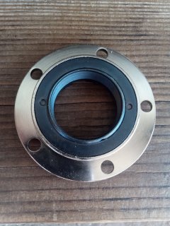

There is another way to do a crankset drive not using a commercial motor unit. It's with a free coast crankset and a remote motor.
I have a crankset hub for that type of build.
It's not a White Brand but seems like one of the better that are available.
Using this should allow me to keep the Q factor as narrow as the chain line will allow which if I utilize 2,2.5,3" wheels should be pretty much the same or even better than the average pedal bike.
