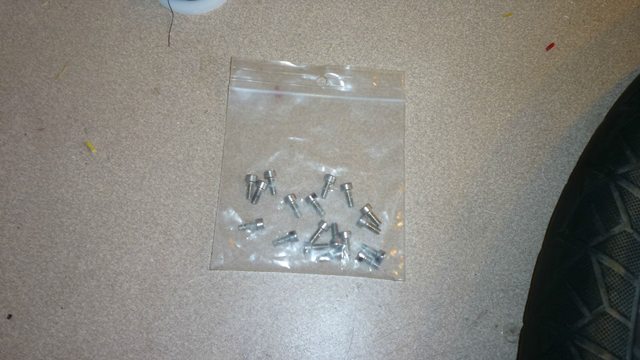

Ok. You CAN use a power drill to undo the bolts. My drill bit set didn't come with the appropriate allen key, but a square bit works. HOWEVER, the screws are made of VERY soft metal and WILL strip VERY EASILY and then you'd be VERY (un)screwed! Loosen first and tighten last manually with an allen key. You're supposed to do this in a star pattern to tension properly, but that's more important when tightening.
This makes life easier.

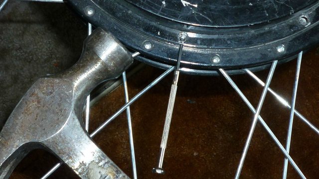

Now use the smallest flat head you have. Eyeglass kits are available at the dollar store and on ebay. Insert it in a screw hole so you may see how far it is going in. It is VERY important that it doesn't go in too far!!!!
If it does, it could break a motor winding and then the motor may be done for (unless you feel like rewinding the damn thing)
EDIT: it's been pointed it out that the screw holes are the weakest point on the cover and you should pry up on them. It's probably fine to tap the screwdriver in there, but don't pry up there. Another option is to mark the maximum depth on the screwdrivers themselves.
Work your way up in sizes going around the motor in a star pattern - careful to not hit the windings. This is hard the first time you open it as the motor is sealed with some water proof glue.
Once it's open big enough to fit the box wrenches in, you should be able to easily pry it off.

The only thing I'd add is to stay away from the bolt holes when popping it open. That is the weakest part of the flange on the cover and where you definitely don't want to mess it up.

Nice guide on opening a hub Aura! I would also mirror John's sentiment about not prying at the screw hole, but rather draw a little depth line on the screwdriver so you know your safe insertion depth limit. I've opened a number of hubs, some of which were well glued/painted tightly shut on the side covers, so I found starting off by inserting the blade from an old razor knife into the gap and tapping it it can help to get a stubborn one open enough to tap in a small screwdriver.
