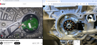

Something like nucular sell on their web site? Other suggestion?
Based on nucular video, it seem that someone already fit this encoder on a Leaf motor.
Awesome information guys. Thanks for that.
I have to learn quite a bit to reach my goal of a reliable project and it's with help like that I will be able to do it.
That kind of thing yes. Nothing obviously wrong with the nucular encoder. It will probably work with whatever controller you have.
