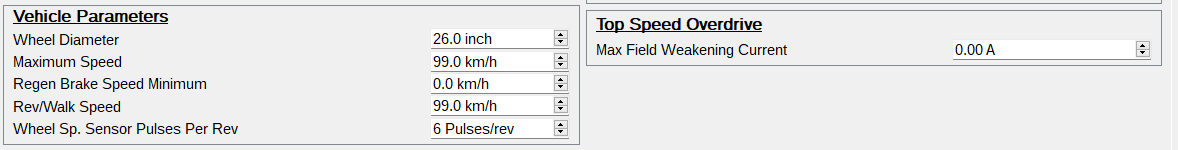

I have a bit of an update with this. I was able to get smooth throttle performance. It turned out to be a hidden parameter (Wheel Speed Sensor) which was set to [2]Hall A. I am not sure which hall sensor that is but it made the phaserunner confused with the wheel speed and it messed up the throttling. I got smooth throttle after changing it to [1]Analog Input 3 or [0]Fwd/Rev or PAS2.
However I am still unable to do regen braking. In the Dashboard screen I can see the "Brake" flag highlight when the brakes are pulled but the "Regen" does not activate even though I have regen enabled on the CA and its throttle output is in the regen voltage range (mine is set up from 0.7V to 0.0V). I suspect it's because the phaserunner is not detecting the vehicle speed. In the graph below I throttled for some seconds and you can see the GMAC 10T RPM go to max RPM (~410 revolutions) which makes sense w/ my 52V battery; however, the vehicle speed remained at 0 kph the entire time (right axis is vehicle speed). According to the software suite the vehicle speed is just a calculation of motor RPM and wheel diameter (which I have set at 6" because the GMAC has a 5:1 gear reduction so the motor spins 5 times faster than the wheel), so there should be some speed calculation but it's just not happening. There is also a Regen Braking Speed Minimum setting that is set to 0 kph, so if the phaserunner thinks the vehicle is at 0kph then that is probably why the regen will not turn on. I am going to email this to Grin. I think this whole issue is just a compatibility error with my v2 Phaserunner. Currently Grin is on phaserunner V6 and the software has had several iterations as well. This whole thing is a bit frustrating but I hope it can be fixed!
Oct 4, 2019
14
I did a bit more testing. I reviewed the V6 phaserunner user manual and the table in section 6.2 states that V1-3 phaserunners should use the Hall A for the wheel speed sensor so I switched it back to that.
These are the settings on my phaserunner:
The issue is that the calculated vehicle speed is erratic and oscillates with negative values as shown in the graph below. The motor regens when the speed is above 0.0 kph. Maybe this is a bad hall sensor? What is strange is that it was working fine before I loaded the "default" phaserunner settings for my system.
Oct 4, 2019
14
FIGURED IT OUT! It turns out that the Wheel Sp. Sensor Pulses Per Rev has to be set to 0. The software suite says that it only matters if a third party display is used so I never thought that the default 6 pulses/rev (GMAC has 6 magnets for speedometer) would do anything. Strange how something that seems so insignificant was the root cause but I am glad it's over. Anyway once I set it to 0 the speed oscillation stopped and I am able to use regen as normal. The wheel diameter also had to be set back to the actual value for the speed to be accurate.
The graph below shows the motor RPM and vehicle speed in sync as it should be, and the speed has no oscillation. :bigthumb:
