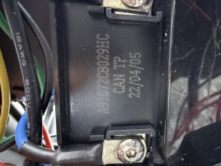

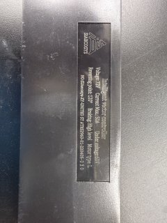

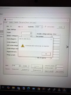

I have corrected the spelling of the name. I have seen it both ways on line. Two types of this scooter were made golf and sport. I am trying to change my golf setting to sport. SIAECOSYS has sent me the program (EM_V3-49V EN) and the ini file. I know the two pins TXD (pin 14) and RXD (pin 15) for the CAN connection but it still won’t connect. I attached two pictures of the controller labels and one picture of the error I keep getting. I am close just need help to get over the finish line.

I have the same machine — a PHAT Golf HD, and my controller is a near-twin of yours. Case stamp A91072C8030HC / CAN TP / 22/06/01 vs your 29HC / 22/04/05. Sequential lot numbers, seven weeks apart, same PHAT order. Posting what I've worked out in case it helps, and because there's nothing else on the internet about these.
@Tommytexzr1 — I think I can see your problem in your error screenshot.
You have CAN enable ticked but baudrate set to 9600. The VOTOL manual is explicit: "Without CAN: 9600 / With CAN: 115200." Your error_count is 0, meaning you got no response at all rather than garbled data — which is what a baud mismatch looks like. Worth trying 115200 before anything else.

1. It is an EM50SP, CAN version. Vincent at SiAECOSYS/QS Motor confirmed by email: "the controller we offer to PHAT is EM50SP controller with CAN bus version." (Damon initially told me it wasn't their product — worth pushing past that.)

115200 with CAN enable
Swapping CAN-H/CAN-L — the manual notes some models need them exchanged
The ~ + Shift advanced page, using Auto_B for the CAN baud
Making sure the controller is properly woken via the e-lock line before connecting
