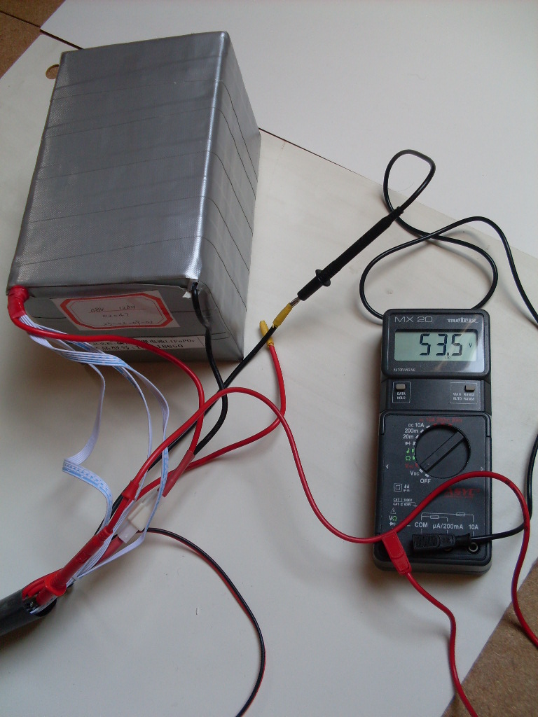

I recieved my battery this week from power_battery_a123 and I just made my first run.
This is a 48v 12Ah and I'm running with a Golden Motor 1000w.
I am very happy with the results because the batterie is very well balanced and it works very well.
When it is charged, each cell is between 3.72V and 3.74V.
I did 25 km without pedaling and it still have some energy.
Looks like my pack right down to the stickers on it. I got a 20AH though.

I guess powerbattery_a123 sent me a 10Ah pack and not a 12Ah.
With the watt's up meter I only measured 9.8 Ah before the BMS cut off the battery. Then I tested each cells and the results are :
they are all at ~2.92v except two at 2.78v and one at 3.01v.
So I don't know if it is a fake 12Ah (but a real 10Ah) or if there are some weaks cells that are limiting the capacity of the whole pack.
Are you just measuring cell groups off the BMS wires? Or did you peel back the duct tape?
I'm curious whether the pack is made from lots of little cells wired together, or fewer but larger cells.
I'm measuring cell groups directly from the BMS wires. But I think the pack is made by a lot of 18650 cells connected together.
