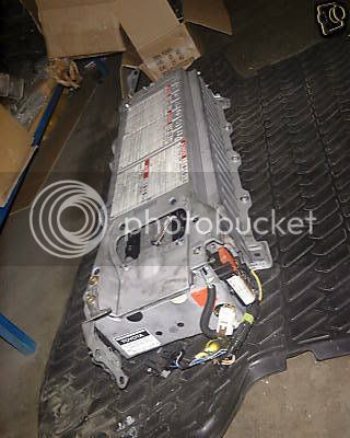

Hi,
can anyone tell me what this label on a Prius battery means?
This is the battery:
What battery is this, how many cells are in it etc?
Does the label mean it has already been recycled, or that it should be recycled?
Thanks!
