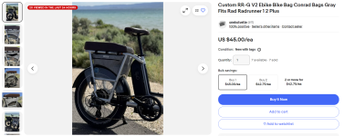

About a year ago my very customized RadRunner Plus was stolen. I've had a few projects under the belt since then, and even some high power bought two wheelers (Luna XXX) but nothing felt quite right.
So when I saw a guy selling a RR+ with the OC Cafe Racer seat already included, I jumped on it:
(How I got it)
