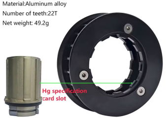

Just saw this today: aliexpress.com/item/1005007950505897.html?
Might be interesting for your project.

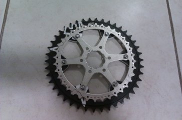

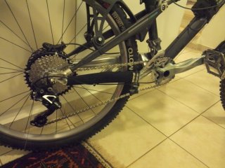

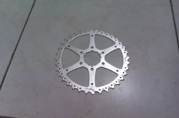

Back in the day, before wide range cassettes and extender cogs were a thing, I wanted to convert a 11-36 cassette to a 11-42 cassette so I made a custom adapter for a 42t cog from an old cassette cog.
Avner.
