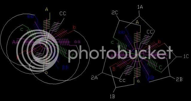

Luke, I am seriously thinking of seperating a set of windings on one of my motors, for an attempt at running multiple controllers.
Ive seen axels home-made motors running that way...
I welcome anyones thoughts regarding the concept.

Regarding separating the windings into 2 sets of 3-phase.
That would provide an advantage depending on how you set it up. To make it easier for the controller you would want to increase the resistance of the phase if you want to keep the same Kv. There are a few Kv's you could actually get from his motor. You have 2 pairs of teeth, per phase, and on each pair of teeth you have 2 seperate conductors, Which gives you 4 conductors per phase that you can connect in any series or parallel combination you want.
You could hook them up in 4 series which would give you the highest resistance and lowest Kv (and be required to use a single high voltage controller)
You could hook them up in 2 series 2 parallel with a single controller. This would give 1/4 the resistance and inductance per phase and 2x the Kv of the 4-series option. This allows you to run 2 controllers (one on each parallel group of phases) so each pase the controller saw would have 1/2 the resistance and inductance and 2x the Kv of the 4-series option.
You could hook them up in 4-parallel. This wold give you 1/16th the resistance and inductance and 4x the Kv of the 4-series option (if you ran with one controller).
However you could run with 2 controllers in parallel (each controller would have 2 parallel coils on it) each controller would then see 1/8 the resistance and inductance, and still 4x the Kv of the 4-series option.
You could also run 4 controllers in parallel, which would then give you 1/4 the resistance and inductance per phase and 4x the Kv of the 4-series option.
And for each of those phase configurations you have star and delta phase connection options, which would take a lot of time to describe.

Here is a diagram for the seperated stator experimant showing terminations.
If I understand correctly, we are limited by the 14 magnet poles of the can. If we upped the magnet(pole) count to 16 we would have the option of ABC termination (& lose the LRK options)
:?: Is there enough info for you to simulate a few motor senario's (all of this will be directly applicable to the Colosus 7KW motors if my suspicions are correct)
If & when you get time, it would be cool to see some compairsons
The goal being: To tame these motors for the controllers & salvage as much of the power potential as possible.
Assuming Delta as the highest potential use, as a base line

I will assume all the conection scenario's listed are for ABC-capable motors
This is wound DLRK for certain & I would call it 13T also from my park flyer experience. The 1/2 turn is either the last 1/2 of or 1st 1/2 turn of the tooth. Not a big deal. "tomayto/tomaahto".
Thud
The diagrams of the stator connections seem to be from a 16-pole 12-tooth stator, the 14/12 will be slightly different but the priciple is the same.
