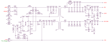

Does the contact "6" control output enable/disable?
When you insert the connector, pin "6" closes to the negative output, and the unit starts.
If you don't need it, you can cut off the track coming from the contact, in the place indicated by the arrow on my photo. And start the unit as before, closing contact 10 on a common wire. And you don't need to glue anything.
Thanks. For temporary testing, I had only Kapton tape on the bottom covering contact "6" so the pre-charge contacts on the top remain accessible. The result is that the in-rush spark appears to be less when connecting to battery without first powering on the R4850g2 *and* the output does not get enabled automatically. This is almost perfect.
I am charging a server rack battery that has pre-charge output so the issue now is that battery appears to repeatedly pre-charge/discharge the R4850g2 output capacitors at low current (~0.1A) when the R4850g2 output is physically connected but not powered even with contact "10" disconnected. This means the battery will slowly get drained when R4850g2 is physically connected which is not acceptable. It's a very strange behavior.
These units are designed for round-the-clock operation, without shutting down. The battery is discharged, not the capacitors, but the dc/dc converter on the control board. The voltage from the output is supplied to it in parallel with the standby voltage through a diode. It is possible to remove the diode, but you are unlikely to be able to do it.
That makes sense ... thanks! For clarity, is the diode you circled D310 on the schematic? The diode doesn't look too hard to remove with a hot air gun assuming the module is not too hard to access. However, would removing the diode cause DC-DC converter output disruption in some situations?
The Chinese remove this diode when they redo the blocks at 90-120 Volts, and the block works without problems. There are 4 revisions of the R4850G2 blocks and the schematics are slightly different. In the photo on the board, in series with the diode, there is a resistance of 2R2. You can delete it.
