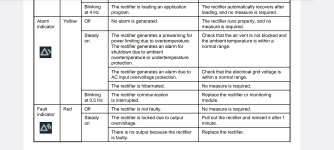

However, few days ago ran into some strange issue. (last 6 months had not a single issue what so ever and was maintenance/support free). Noticed that system was charging on and off like charge for 1 minute at 40amp, then off for 30 seconds and back on. Went out, reset everything just to be safe, and same issue. When the system is not charging during those waves, I hear a click from PS right before it shuts down and then see solid red light. Then it "recovers and starts charging again for a minte or so. If I set teh charging to 25amps, zero issues nad it charges all night long. Second I ge to 30 and above, same issue continues. I did monitor the voltage at BMS and it never jumps or goes up that I can see to warrant over-voltage (red light seems to mean overvoltage from the user manual). Anyone seen any similar behaviors from these units?
With your external fan, you reduce the fan speed from the internal fan, probably now other components inside that are only air cooled get to hot.
Solid red is no good sign.
Internal fan always sounded/sounds like its fully running once im at 30+ amps. Also the external fan is part of the body now positioned right in the middle of the body and has airflow about 3 times the internal fan. There is a chance its actually outflowing the original fan and pushing air backwards through it. I did IR reading on the components when I first built it it and with external fan I saw about 30% temp drop throughout every big component I could get a picture of.
Also this setup worked Perfectly charging at over 95F ambient 5+ hours (texas summer) and temps never got over 55/60c while stock fan couldnt keep it cooled for prolongued time at those ambient temps. I might be wronog but dont Think its temp related. Also part of my code is to first throttle back reported temps and then cool down for 10 min if we touch 60.
The internal fan does not even spin full at 80A and 35C / 95F.
But if you checked with an IR cam then you are probably right that it is not temperature related.

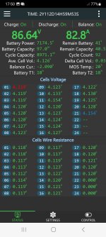

I use them for charging my 7,7kwh scooter battery.
Thanks will give that a try. However yesterday I limited the charging to 25amp in the code. Once the free time came, it started to charge, charged for few minutes, and then went back to some weird state. The charging dc reported limit fell to 17.3amp with 0amp flowing out, fan on slow speed, No red lights just single green this time, and unit making clicking noises. Shut it down via can with dc/ac still love, waited a minute, requested to turn on again. Still clicking with no output. 20 seconds later goes to 25amp and zero interruptions all night charging 12kwh.

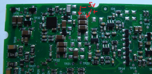

Hello,
I have a different PCB layout and can´t figure out where to get 5V to supply an ESP32 for CAN control.
I tried differnt spots where I measured 5V (or 3.3V) but when I connect the ESP it drops to about 1V.
Anyone a hint for me?
Thank you and Best Regards,
Daniel
Most of the electronics inside ought to be powered from 5v. Most chips will probably have bypass capacitors next to their supply pins, and you should be able to tap 5v from that, unless the PSU you have is designed with such a marginal 5v regulator design that can just barely supply enough current to run the PSU's internals, so when you add your ESP32 load it shuts down.
I added a small dc/dc for the esp32 and took power from the 12V rail in my r4875g5
