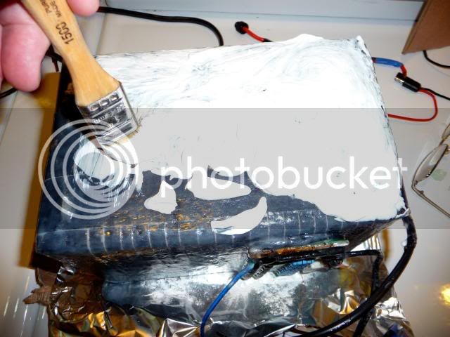

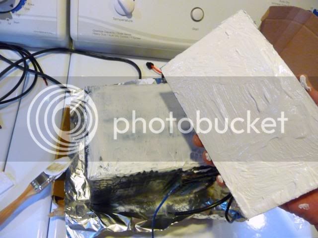

=The pack is not epoxy potted (nor did you imply that it were so-treated).
It is only double-wrapped now with an added layer of super-quality duct tape (that Gorilla brand stuff).
Prep for that step: the pack was scuff-rubbed with steel wool and then super-cleaned with wipings with isopropyl alcohol,
to ensure best bonding of the Gorilla brand tape. The tape applied, was then rubbed, rubbed, rubbed with a pressing cloth
between a warm, small footprint sealing iron, to fully melt and bed the thick adhesive of the new tape, to the OEM cheap quality duct tape. This, for water sealing, as too, the corners and wire exit points were also sealed with Perfect Glue (silicone)#1.

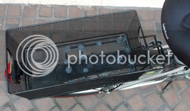

=Now, the cementing of the pack into the basket should be more or less permanent, yet, reversible if the pack
should ever need to come out. To remove the pack: I'd invert the bike for several days and see if the RTV begins to lose its grip to the scuff-rubbed bottom of the taped pack. If not, then I'd flood the area with mineral spirits or naptha, which will weaken the RTV and allow the pack to be removed (with that gravity assist of fifteen pounds of upside down PING battery.
The BMS is the only portion fully epoxy encapsulated. It is a non-servicable part, should it ever fail, yet can be swapped out easily enough if it were to fail.
The plug connector to the BMS can be disconnected in situ, which will allow manual checking of cell balances at any time in the future: that is, I can tell if ever a cell goes bad.
This type of battery is not prone to cell puffing, but if a cell were to puff at all, visual examination will reveal that fact,
and the battery pack then removed and sent in (or serviced by myself) to replace any bad cell.
Center of gravity: a basket mount battery pack is not ideal for nimble handling;
but then again, neither is a rider sitting tall above the saddle in non-aero stance.
Advantage of this mount: the bike still looks like a ho-hum, uninteresting single speed bike = less curiosity raised in onlookers and thieves, etc.

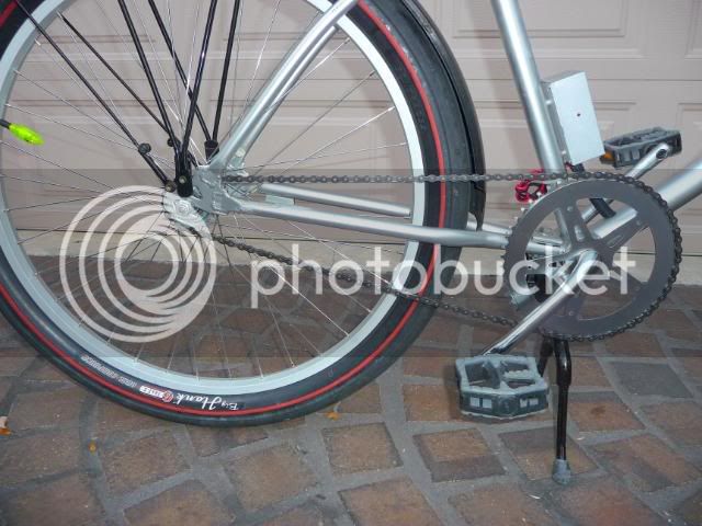

It will pedal normally, freewheel as any normal bike, and with its coaster brake freewheel: dead silent whilst manual pedaling/coasting.
The weight at present is sixty five pounds. The range of this 36V, 20Ah, geared front hub motor bike (no front brake)

The chainwheel has already been exchanged from a 48T (I forget) to a 52T, the largest readily available.

The battery mount: the rack of steel and steel basket are adequate, but how to prevent upthrow of the 15lb Ping on rough, offroad turf, or bombing over a curb? The first idea was to silicone-glue the duct taped battery to the basket.
Too bad: silicone rubber glue does not actually bond to the vinyl (?) coating of duct tape.
Therefore, the next step (and the battery must always be removable for inspection or service, will be to try this:
Blue Tack the bottom perimeter of the Ping pack. Press it home into the mesh basket.
The battery stands a bit taller than the sides of the little mesh basket. Mason's cord, high strength nylon, white color
(the only color the hardware store sells, and I want it to be black color) is at present soaking in Rit fabric dye...nylon takes dye color through and through.
With this Blue Tack on the bottom doing the basic sticking-down of the battery, and then a lacing-over of the top of the pack,
I think a bump-proof mounting will be achieved. When this is done I'll helmet mount the little casio digicam and make a wild ride,

BIG THANKS go again to Coral Way Bike Shop of Miami, the folks who sold me the Sun Kruiser, a quality, basic steel bike, for $200 last November; the solid foundation for this project.
I wanted to obtain a complete, spare rear wheel, in case I ever break a spoke or bend a rim or wear out any of the coaster brake mechanism.
And too, I want to decrease the rear cog from 18T OEM to as small as possible, to gear up the bike for pedal assisting above the eZee's 20mph.
As it turns out: the smallest cog they can get for this rear wheel hub is 16T; that will be a help.
Ordered on Monday, the wheel and the 16T cog were ready to pick up from their shop today.
Cost? $35 for the complete wheel with all the OEM hardware, free for the 16T cog, and 12 bucks for a skinny chain,
derailleur chain, which fits this single speed bike's cogs better; less side slop,
and the long chain is lighter too than regular single speed chain, and will run even quieter.
I'm swapping in the new cog and replenishing the coaster brake's grease now.

= a new, spare rear Sun Kruiser wheel to have on hand for parts-needs in the future. It cost only $35US from the LBS.
=exchanging the OEM 18T rear cog for a 16T cog, for better (slower) spinning-assist at 20mph and over

now to apply a first coat of water-based, waterproof-when-dry PVC glue
it dries rubbery and clear, but how well will it bond to the vinyl coat of the duct tape? answer to be determined by service success or failure
speed curing/drying the first thin coat at 140F. more coats will be applied.

the beauty of single speed: 52T front and 16T rear and narrow chain in a straight line: maximum power transfer,
great ease of maintenance
. and it looks... :roll: manly (jk, but true).
bike as it is at the moment, ready for a manual pedal ride which I just completed. this ratio is still fine for level roads,
provided there's no headwind. it makes for stronger legs too. I'll use this ratio for pedal assist, especially above 20mph.
So you see, it's a medium speed ebike, but ultra clean and simple looking, and it will be bulletproof as can be,
and also take to water waist deep like a duck: a true, triple hybrid bike like none the world has ever seen before.

Real-time photos, slow baking to speed cure between coats
This brand is a bit thicker and is better for building up coats, yet, below, you'll see an even better product: the cauking stuff
See how the thickness of this soft, rubbery, removable, waterproof stuff builds up?
I "invent" as I go along, sometimes with successful results. Instead of cloth or foam under the battery: 1/4" foam board.
This will have its edges blackened with a magic marker, and then heavily cemented to the bottom of the PING with...
Black edges to make the mount invisible when the pack is put into the black mesh basket
Learning by doing: what I should have used all along instead of the fabric glues above. This Polyseamseal is the -identical-
chemistry (PVC-E), just more viscous. It spreads on thick and smoothly with a brush and can be filleted with a wetted finger
We heavily glue the foam board to the entire bottom of the pack; this will take some time to fully cure, as it is not
fully exposed to air, but in time it will fully dry, turn clear and fully bond to the bottom of the pack
The stuff is tacky to the touch, but not sticky. It is anti-slip unless dusted with talcum powder. This coat on the bottommost
side of the foam board is very thickly applied, and will bed into the mesh of the basket bottom, preventing side-slippage.
Nylon string, dyed black, will then be laced over and around the pack multiple times to secure the 15 pound battery from jumping up.
The foam board will offer some slight compression and will take some compression set to make the unit-seating pressure even across the bottom of the pack:
this is a hardtail bike and the upthrows will be contrained by the tie cords, and the down-slams absorbed to some extent
by the slightly crushable, yet slightly resilient foam board.
Now we just let it bake at 140F for a number of hours, and then lay it into the bike's basket, feeding the three wires down and out the bottom of the basket. And then lace the battery in place with my custom-dyed high strength masons' nylon string.

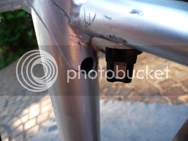

Today: pull the two power wires up the seat post tube. Holes have to be made.
At the top of the seat tube, but below the point where the Thudbuster post stops, two exit holes are made.
One exit hole is for the red wire, to feed right into the kill switch. That wire will continue out from the other side of the kill switch.
In the photos you see the hole-making operations, and pulling the wires, and disguising the bright red plus wire at its exit point
with a couple of inches of black heat shrink.
These holes all will be "grommeted " with PVC caulk later, so that no water can ever enter the seat post tube;
this caulking stuff is adhering, yet easily removed when and if the need arises.

The rack is now leveled, secured, ready for the battery pack to install (when it's finished baking its coating),
then a simple connection to the kill switch and installation of the trailer-type charger plug, all under the basket out of normal sight.
The wire run from basket to seat tube will be more or less invisible to the casual eye.
And then string-tie that pack securely to the basket, and decide how or if to cover it with cloth or nylon cloth for neat appearance.
