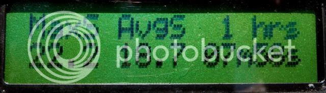

The range of the bike with its Ping 36/20 appears to be about 35 miles unassisted;
so my normal depth of discharge is quite low, as most trips are under 10 miles.

74F, 4AM, sea level, no breeze,
no traffic, no stops of any sort. Flatland.
36V/20Ah PING battery.

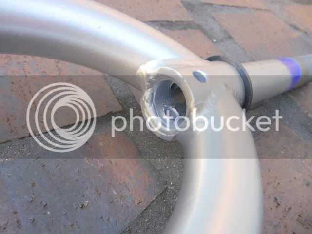

As you all know, several weeks ago I took a header, flying through the air.
The eZee wound-up its self, its wire lead-ins, in the steel dropouts, but the front wheel,
of course, it did not come off. Lawyer lips, tight nuts, all perfect. Yet, I shall fit a torque arm soon.
The top of the stem took a mighty bash; I =could= have re-used it;
hell, I could have re-used the spread-lip fork. I just won't do that.
From the LBS, that $200 chinese cruiser. Locally imported, distributed, SunKruiser.
Ordered a new fork three days ago.
Yesterday the fork arrived, but it was the wrong version: with lugs for caliper brakes.
Ray got on the phone with JB Importers. "SORRY".
"We'll have it tomorrow by five PM, the right fork."
"Alberto will pull and re-mount the headstock bearing ring---special puller and press tool".

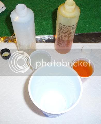

Here it is. What's next? Tonight I fill the hollow steel (which is so strong, anyway),
with semi-hard bartop epoxy. This makes the fork much stronger yet, and I =could=
soak it for a month in the bay water: no internal rusting possible.
The drain holes you see are universal to all bikes.
All steel bikes are wet inside from wash and rain water.
They rust, invisibly, and some year, will fail at some unexpected time.
Not so, this bike.
Big pictures to come soon will show the epoxy step.

Finally getting to work on the new fork.
The images are fairly self-explanatory.
FIRST: plug the water drain holes at the bottom with five minute epoxy PUTTY,
and with a sharp blade, shave off the excess, then rough file, then,
I drill the dropouts for American NF screws: 1/4 x 28TPI. I just like that size, and easy to get those screws here in Miami.
Then under the outdoor faucet, SCRUB and de-oil the fork (I had only WD-40 for a a tapping oil).
Then 360 rubbing. Note the various colours? Blue was the factory's base filler-colour, then grey primer,
then silver, then clear coat. It looks like hell but is smooth as silk to the touch.
The fork is FILLED WITH NON-BRITTLE bartop-pour epoxy. Really not necessary;
but it does make the tapered ends of the fork ever so much stronger, and they are STRONG, even hollow.
See that in order to fill the fork with ten ounces of slow-setting bartop epoxy with a plastic syringe,
I found it necessary to make fill-holes atop the crown? Then I filled until the liquid got to that level
of the inside-the-headstock holes. And after the epoxy was cured about ten hours later,
plugged the inside holes and upper, crown-fill holes, with the putty epoxy.
This, to repeat again, is being done to make the bike submarine-safe: that I could leave it out of doors in pouring rains,
or drive through flooded streets we get here every other year or so, for stunts, for fun, for PROOF
that an ebike can go where NO other wheeled vehicle goes...and it won't slowly rust out from the inside.
This is the world's first truly submarine-capable-toss-it-in-the-pool ebike!

Surely you know, that for its weight, bamboo is strong. That it and bicycle tubing are hollow is not a coincidence.
I think the fork legs will perform like tubing regardless of the epoxy fill considering the disparate properties of the materials.
PS: The weep hole in the tubes is there to let the heated gases escape during welding.
