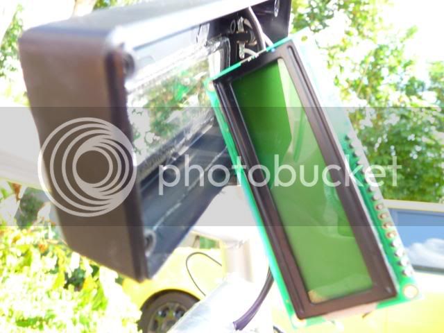

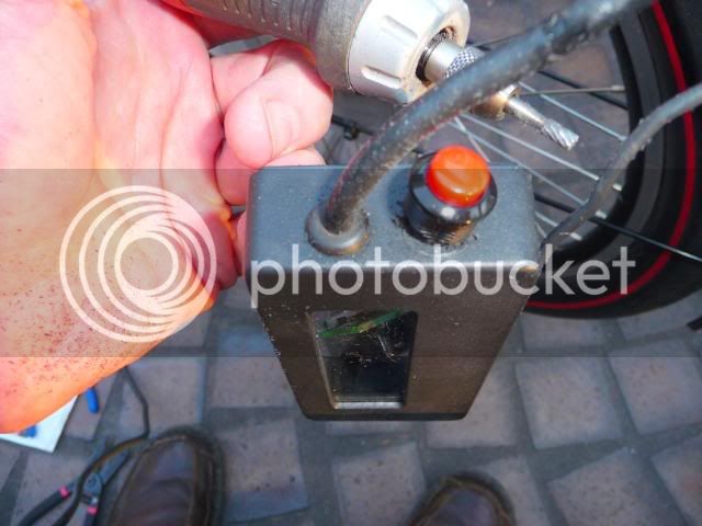

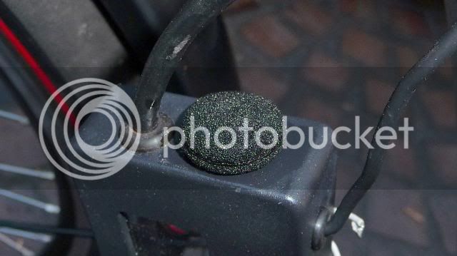

Proofing the Cycle Analyst against moisture entry will be the biggest challenge. Things with wire entry points are a challenge to truly seal, particularly against pressurized water (as when/if the CA is put several feet under water);
its mode switch must be capped with a rubber button-cover of some sort.

Waterproofing must be done at some point. For now I must solder the two leads of Justin's 12 LED headlight
to the CA's 36V input power (the headlight has an inbuilt voltage converter and regulator to drop the volts down to the LED's needs).

Now to the Cycle Anylyst: I want it to be fully dunkable. The side switch needs to be replaced with one amenable to a neat sealing job.
Earphone bud coated with that very nice-handling silicone glue, Perfect Glue #1.
A spacer (a rubber grommet probably) may be needed to space out the new, longer N.O. switch.
Wire in the 12LED headlight from Justin's firm to the V+ and G pads on the Analyst board, seal,
done. Should be good for five or ten feet underwater (not that I'd go that deep), only due to the plastic window of the C.A.
'cos it's not a submarine pressure hull :wink:
Notes: a second application of Perfect Glue will be applied in a couple of hours (it will bond to previous coats)
I may need to install a loose rubber grommet =under= the switch flange, to space the switch body out, away from the board; not a problem if that's necessary: once the clamping nut is lightly tightened: no water at all can enter this one weak point of the C. A.

Boy, it's tight in there. The new, normally open, push button mode-switch needs an ugly spacer grommet to allow for the board to fit as per original. It looks clunky, but so it goes. (not seen here in these pictures, not yet)
Some people collect grommets like other people collect pancakes or roadkill :lol:
the hole in the back plate: entry for the lead to the 12LED flood.
QUESTION, just to be sure: I connect its red and black to the red and black pads,
the far left and far right, seen in the final picture, righto?
I can check with a multimeter for presence for the battery voltage, full, that should be there when I've turned the system on.
For the moment: silicone glue and PVC glues are drying.
Not shown: a tiny vent hole was put into the back plate, to be covered with a bit of adhesive tape,
in case slight condensation ever gets into the CA: open the hole and let the unit dry out in the sun.
The case back will be lightly silicone-glued shut for a water seal.
Then we test the lamp and C. A. by long submersion in a bucket of water, to ensure that it's all watertight enough.
Then re-clamp it all to the bars and look for a water sprinkler. Or rainstorm. Or pool. :p
