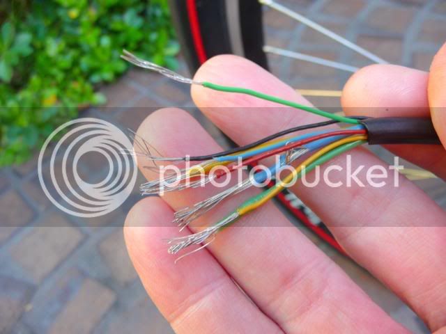

#8: Two cables to solder-connect: all the little wires conjoined as one cable. And then fish the lengths of all the cables (main, Cycle Analyst and thumb throttle, through the bikes thick-walled, fat tubing, dowward toward the controller, exiting from a generous hole to be drilled just below the controller.
Some generous excess of cables' lengths will remain, stuffed inside the frame tube, to make it easy to remove the front wheel for basic servicing,
by pulling out cable from the tube, as needed. These holes will be grommetted and water-sealed.
#9 Exampling a right-proper soldering-in-line of two heavy gauge wires; eight gauge, I reckon.
Full solder penetration. Paste rosin flux, Radio Shack butane iron. Get now-banned 60/40 lead solder whilst you can; it's not brittle
like the new, lead-free lousy solders must be, lacking ductile lead.

And then some few hours to carefully splice the controller cable to the motor cable (YES, I did purposefully CLIP off the former quick-connectors;
had too: no other way to fish/pull the main cable through the bike tubing. YES, the other end of that cable will also be clipped, and then....
we will decide whether to re-use the quick disconnects, or simply use the superior though bulkier, compression screw connectors.

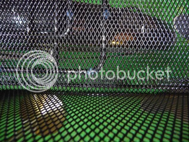

Just got back from The Container Store. Found for $12US the =perfect= holder for the battery.
Will make a mock up picture of that soon as I digest dinner and rest for a spell.
Then later tonight (I am a night person), I will solder the hub motor leads to the controller leads (at the front wheel vicinity)
and use galvanized wire to super-tie the new mesh steel basket to the rack, then double-stick tape the Ping into the basket,
and also tie or otherwise fasten the Ping so that it cannot possibly bounce up, or tear off in a sideways fall of the bike.
It is going to look good. I got a much better basket than I thought I'd find: it has high sides, just an inch or so less tall than the Ping.

I need to solder the hub motor wires to the main cable, neat,
for a pull-through-the-frame tube job. Here is the "beauty" this AM, ten minutes ago:

From USA's "The Container Store". Perfect.
Room for a chain lock. Box wire-tied to the rack, very secure.
IF I decide to paint the steel mesh basket BLACK, the battery will visually disappear.
Today I must splice the (cut off) motor cable to the controller cable. I hate precision work: three pair of reader glasses stacked,
so that my lousy eyes can really see what I am doing with the solder connections.
The splices will be staggered in position so the cable won't be "lumpy", and then wrapped in silicone tape,
and then....
....then the cabling will go through the main tubing, to the controller box area. I hate this present lash-up look.

These remaining pictures are self explanatory. It will be a nice looking normal looking bike at the finish.
I do think: gloss black for the basket will be best, though (to hide the battery and chain lock.
The battery and chain lock will be secured from bounce-up by some sort of mesh nylon elastic cover,
and glue for the battery, too.
I hope my friend, Ping, approves. The battery will be safe from side-dumps or upside-down air flights.

The next step is to tack-glue the basket to the rack (just to get it all nicely squared, aligned, with Elmer's Stix All
(a silicone rubber glue that does not go "bad" in the tube once opened).
Then two hours after that, the Stix-All is set-up, I can WIRE TIE the mesh basket to the rack with light gauge
galvanized tie wire, many points of attachment.
Basket will be superbly unitized to the incredibly rugged USA-made Wald brand rear rack.

Acetone to clean the Wald rack.
My fugly "medusa" photo lighting system. You can't have too much light (daylight is best, of course).
"Stix All" is a conventional RTV silicone glue, except that it does not "go bad" once opened and used, like other brands do.
A few dollops of Stix All. The blue tape is squared, and tells me where to locate the basket, clearance from the cantilevering seat.
A big dollop on the crown of the Planet Bike fender to keep it from shaking side to side (the fender is not yet perfectly aligned).
Plenty of time to align the basket, both by measurement, long straightedge (not shown) and by eyeball, too)
Li Ping's wonderful LiFePo4 battery as a weight; waxed paper to keep it from sticking to the adhesive.
Looks pretty good. The tail of the plastic fender still requires squaring-up. Can do that later on.
