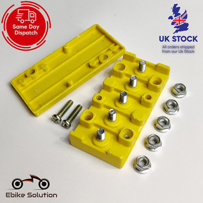

I ordered this a few days ago but I am thinking it isn't small enough for the 9 pin wires? thx

If you hunt around you may find a KT controller and display with waterproof Julet cables, although these can be a real pain when you are testing and fault finding on a new installation because it’s even harder to get your multimeter probes on.
Another common type are JST-SM connectors. Grin Technologies have standardised their controller connectors to JST-SM, so I copied them for my controller.
The top bike controller has a mixture of connector types, mostly JST-SM, so you may need to change one or two of them, specifically the hall sensor connector, which is sometimes described as a molex.

That's exactly what I have but if it's 1-2 ft longer it will reach the controllers new home. As is it just might work but will be tight/ limiting when connecting the wires to the controller.
How will the controller wires connect to this cord? Cut and splice? any diagrams exist on correctly connecting the wires that I'm sure are non matching colors.

I just cut off the cables that were hard wired to the old controller and used JST-SM connectors on the bare ends to connect to the new controller. My LCD03 display came fitted with a JST-SM connector, so that was plug and play.
Battery and phase wires are connected to the 5 way connection block using ring terminals.
I put JST-SM connectors on the Hall wires and PAS wires that I cut off the old controller. I had to buy a Julet throttle extension cable and stuck a JST-SM cable on one end.

I received the 5 way block so I wired up the big wires. I'm presuming the wire colors are matched up , no swapping around. Is that correct?
