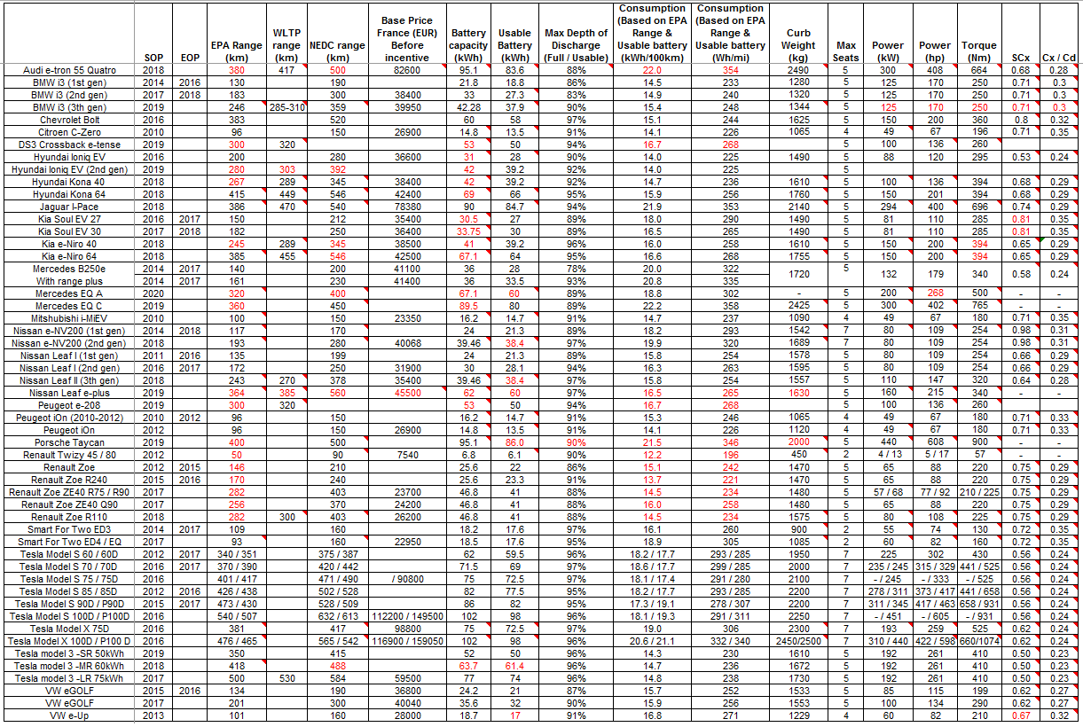

Have you found similar information for Hybrid Vehicles, this was really helpful, but I need similar information for Hybrid Vehicles, I am not able to correctly identify cell weight. how did you collect this information.?
Here is the link to the original author of the spreadsheet.
You might find good info t here. there are many many EV forum spreadsheets available nowadays if you look. People love making them. Many more today rather the ones I found all those years ago.
thank the Chris guy for this one. There are tons nowadays if you just google
EV battery spreadsheet" anymore.. but the guy was the original one that I linked. Here it is.
