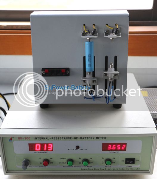

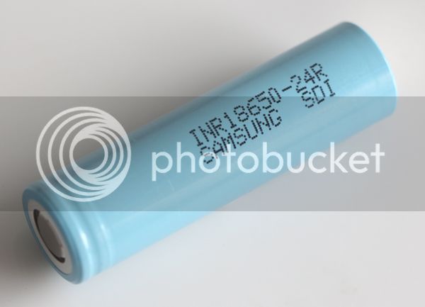

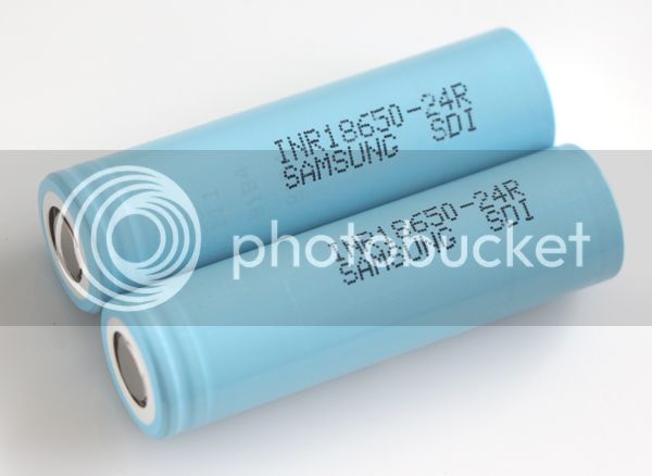

It seems in the next couple of weeks there is going to be a 24R version of this cell available :). Some samples are on their way here. I'll review once I get them. Some pictures as always. 2.4AH hell yeah!
only 13mOhm with 2,4Ah?
thats awesome!!
What exactly chemistry they have and do they need balancing?

The increased capacity of the 24R is a good development (20R=2000mAh, 24R=2400mAh).
I have a running theory that the increased C-rate of these cells are a result of an increased number of internal parallel sub-cells. Just a theory, but...enough people have tested and run the headway and Samsung 20R cells that I do believe they provide a high C-rate. But if their respective chemistries are common old-school (LiFePO4 and LiMn), how can they provide the higher C-rate without getting hot?
I saw a video a while back showing how cells are manufactured, and the 18650's are a long ribbon of the same material that is used to make the flat foil packs, but in an 18650, the ribbon is rolled up. The clue for me is that the higher-C-rate cells have a lower capacity, so...what takes up the extra room inside the cell, causing the lower capacity? dividing up the internal ribbon into several smaller sub-cells that are connected in parallel might be one reason. Since the 20R used in a common size of pack can safely provide over 60A of peak current (and 40-ish amps of constant?), the 24R cell would be the best possible cell configuration for my needs. I hope to perform surgery on one of these soon.
A higher amount of amp-hours in the same size of pack while still providing over a 25A constant C-rate and 35A peak would be great, as long as the other performance characteristics were not compromised. Only time will tell, but now I am very interested in these 24R's...
