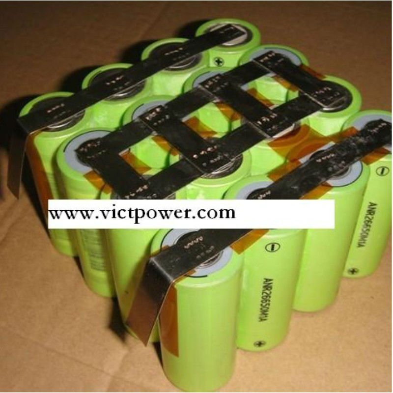

Rollodo said:
Can these 24R cells be constructed together in series and then be put together like LiPo's - meaning, just plug them together in series or parallel, whichever you desire? If there was a pack using these in 3S2P, or 11.1V 4800mAh, that could be a reusable module down the line. ..
That sounds exactly like a "laptop" pack ! :wink:
..or even a power tool pack if you prefer 18v.

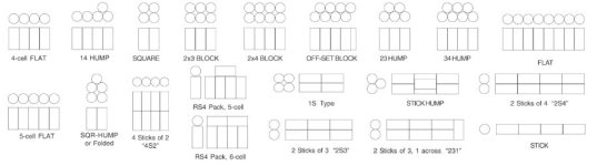

The "ultimate" solution i would like to see is a modular "Cell Holder" or "nesting" system similar to those available for the large Headway cylindrical 10Ahr cells.
A pack system where you can
simply slip your 18650's into individual locations with inbuilt pressure connections (ie, no soldering or welding), and by reconfiguring a few (non cell) connections, end up with any series / parallel arrangement you want and also configure the overall pack "shape" to suit your space.
This would obviously add some extra weight, but the advantage of easy assembly and individual cell replacement would compensate.
