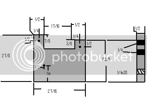

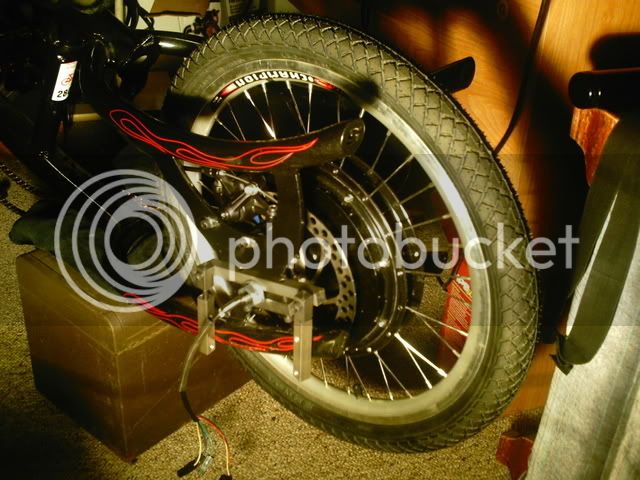

You're too kind, just for embarassing me, you gotta bring your own Dew. Here is another update for the Stripper. The brake caliper plate is DONE! :D Sans minor tweaking, here it is.
The Spoiler is in the unique position of most likely NOT needing one. After fitment testing this morning, it looks like all I need is longer mounting bolts, and a batch of washers to shim the rotor, and the caliper toward each other. All I need is a half inch. Well Parker, I would say $500 was a good deal. Especially since they sold new for between $650 and $750, came in limited numbers, and in the condition your bike is in. I didn't notice if the Squadron handlebars are different than the regular OCC bikes. Admin may have something to say about it, but as far as I'm concerned, as long as a question or comment about these bikes is posed, you can yak all ya want here. This is my little padded cell in the asylum. :mrgreen:

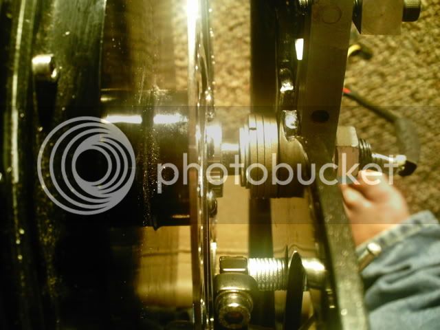

Here's what I did on my day off. Err, better make it weekend alone. On Saturday, I went outside! I limped to the bus stop two blocks away. After mugging the bus driver with a wet noodle, I made him take me shopping! :D :twisted: When I got back I had fresh milk, Dews, and screws! :lol: I swear, I never did anything without their permission. :wink: They had a bunch of nice M5 and M6 parts at the hardware store, but I only drive American.
The first two pics are of the Stripper with Hyena's Rotor installed, and his Caliper in place, above the tourqe arm.
The next two show the new washers that shim the rotor on the Spoiler out enough for the factory caliper to fit between the rotor and motor. Also you might be able to make out the two rows of washers above the axle, that shim the caliper into alignment.
I'm not sure how well that caliper will work shimmed out 3/4 of an inch with washers, any ideas? I can't wait for the parts from the shop to arive. With any luck at all, I'll be riding next year for sure. Edit, I almost forgot, Hi Kim!

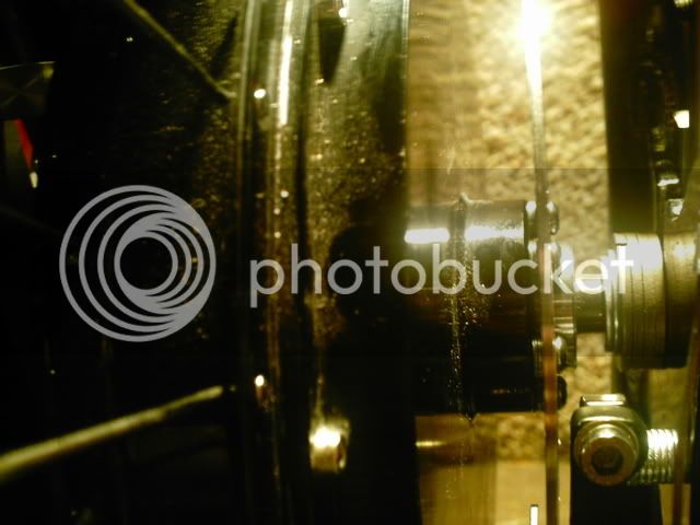

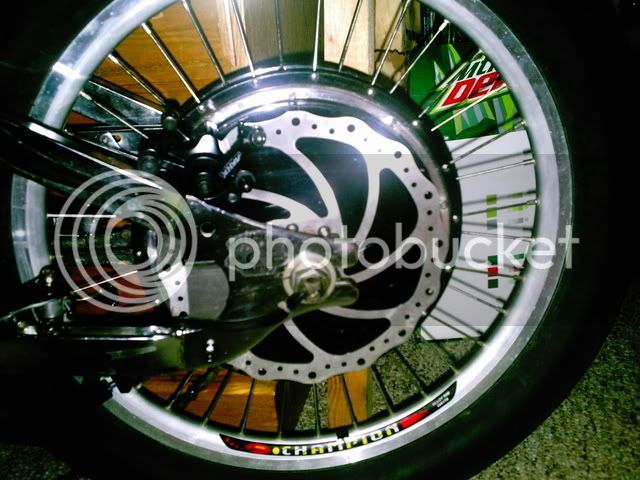

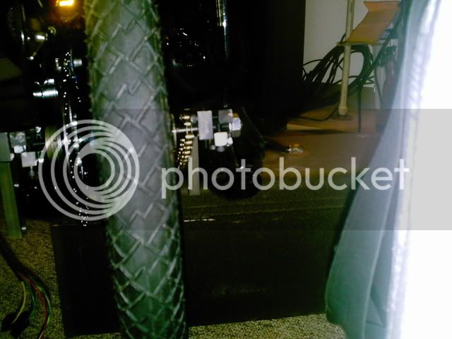

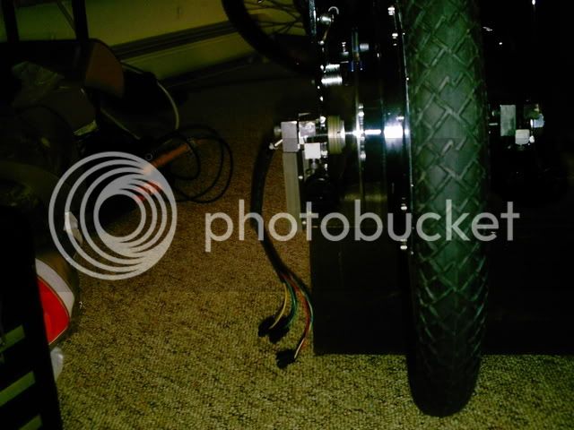

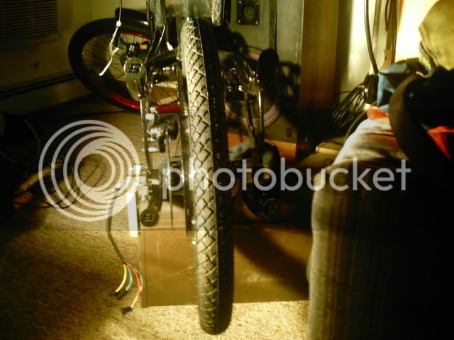

Mabye these pics will show the issue a bit better. Cheap 3 MP cam needs to go. Anyway, Parker, thanks that rotor is a 203 mm unit from OZ, and the caliper is an Airtek piece that has a shady reputation. :( Aparently, they like to freeze up on the rider while in motion, leaving you with a frozen brake lever, and NO BRAKES! I looked mine over good and the thing looks fine, so I'll try it out on the Stripper. Now for the Spoiler issue. Below the standard 180 mm disk, that I think looks nicer.
And in this one, you can see the gap between the caliper and the hub motor.
This one shows the washers between the hub and rotor, there are three.
And finally, the real issue, there are 11 washers between the frame and the caliper. My question is, Is that too many washers?
Sorry for the nudity. :shock: I'm not surprised about that spoke nipple issue, these Schwinn factory wheels are crap. The spokes are too thin for an adult, and the rims are weak! Don't confuse these Spoilers and OCC bikes for anything other than what they are, cruisers, in other words, road bikes for the relaxed set. They can be used for Ebike builds due to the strong frames, but almost everything else has to go. You can add gears to them and make them faster and better at hills, but they will never be competitive with sport bikes or BMX as they are too heavy. The Spoiler does come with some awesome brakes don't it!

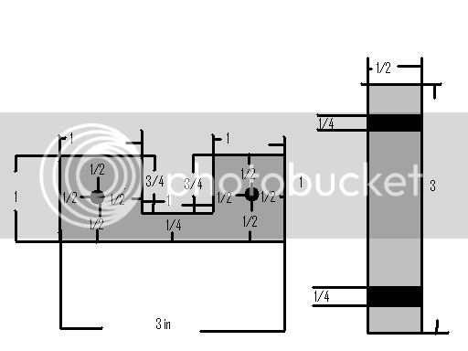

Due to the lack of any response, I decided to ask the machine shop to make a spacer plate for the rear caliper on the Spoiler.
This drawing was submitted today.
Again, thanks to all who offer their input.
