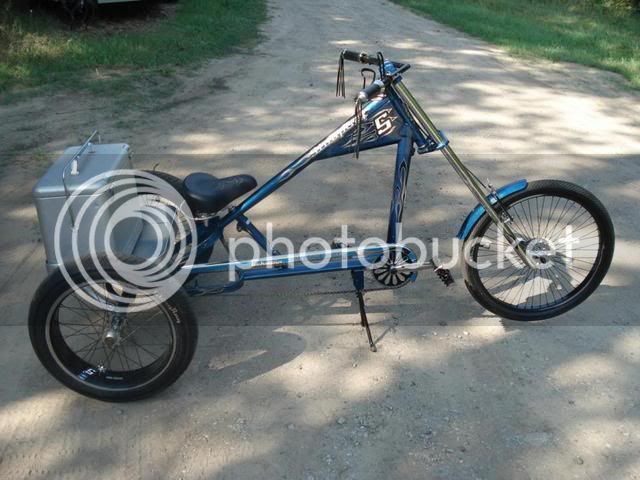

I wanted to make a trike outta my spoiler after seeing this pic...
and am still thinking about it.
There have been the odd trike build(s) pop up on the Schwinn forums but after an update a lot of the pics went bye bye :roll: I havent seen a hub motored trike yet that I can remember. Maybe build a normal trike and put your hub motor as a mid-drive.
An XL chopper trike form schwinn forums.
http://www.schwinnbikes.com/schwinn-life/forums/showthread.php?84689-XL-Chopper-Trike
I saved off these pics last year when I was thinking of a trike build. In pic 2 attachment, you could place the hub motor where the back wheel should have been.

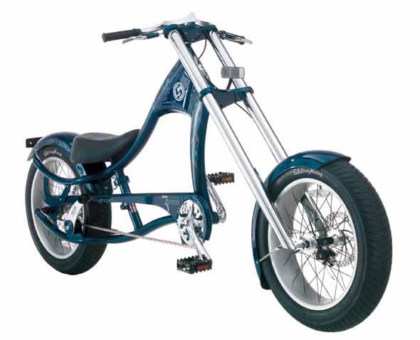

There were a few variations on the chopper bikes made by schwinn - Stingray with various colour scemes. Stingray electric - Spoiler - XL (rare) - XXL (very rare) and the Spoiler SS 3 speed/double fat tyre ( the rarest of the lot). The Spoiler SS was in the schwinn catolog for a short time but it was when the chopper fad was declining so there was only ever one made before they pulled the plug on all the choppers.
Spoiler SS

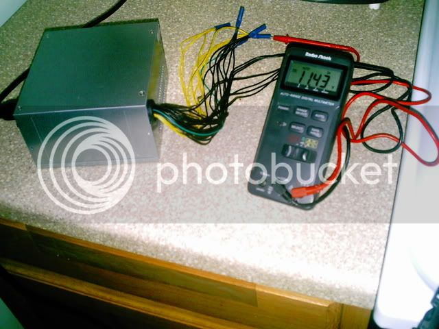

Here's a little project I did yesterday and today to pass the time. I'm waiting for parts from oversea's. After reading this thread, http://endless-sphere.com/forums/viewtopic.php?f=14&t=31421 I decided to try it myself. Surprised myself, I thought that I had failed. The first time I plugged it in, nothing happened, no fan, no smoke. I went back a few hours later with the DMM to see what was what. Still no fan, but had power. After takeing the pic I checked again, and the fan was on.
I'm not happy with the output power, seems a bit low. Not bad for my first PS hack though. Not bad for a one arm bandit huh!

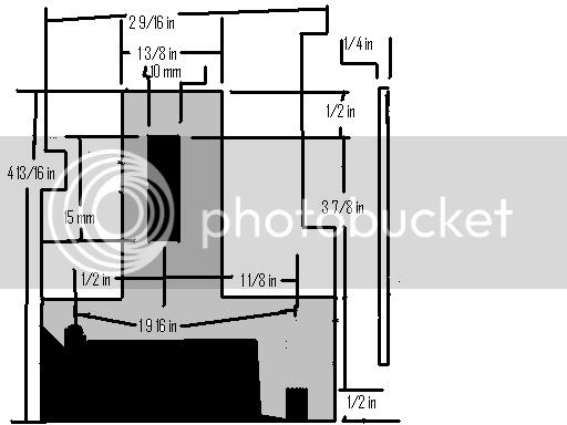

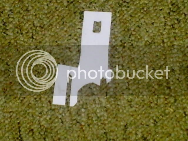

I'm working as fast as I can man. Us poor folk need time to get er done! A rear caliper mount for the bike, along with battery bag is still needed. The Big bike still needs tourqe straps also. I figure by this time next year, I should have one done. I am looking forward to that ride together too. Thanks for keeping the faith. Here's a early drawing for the rear brake caliper mount for both bikes.
Brian L.

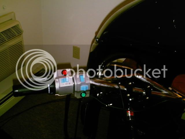

a first look at Hyena's switches on the Spoiler.
Brian L.
Those look a lot better than the simple thing I bought for my lights/indicators/horn etc

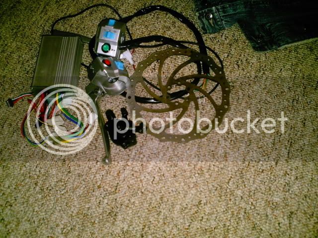

Or hiding my embarassment under a black helmet. Time for another OOPS! I GOOFED! moment. :oops: Earlier I said that the switches I bought from OZ had the wrong type of pressure switches under the brake handles. That was wrong, they are the right ones. After a few hours rest, I was thinking about it moments ago, and I realised that auto brake switches operate the same way Ebrake switches do. So I broke out the DMM [again] and retested the switch I removed from one assembly last night, and TADA it is fine. I have no reason for the oversight. I guess I was just tired from a long day. I spent five laborous hours creating that stupid looking piece of paper I photographed, and then I went and tried to help out a neighbor, which backfired. Anyway, I must apologise to Hyena for saying something that wasn't true about his parts. SORRY MATE!
I emailed Justin at Ebikes.CA, and asked about brake rotor screws for the rear 9C hubs I have, since one was shipped from New York without them. He said they should be available at the local bike shop as they are M5 threads. I didn't know that either! Just got off the phone with Michaels Cycles, and the screws are four bucks for a set, but he couldn't tell me the thread size, but did say they are all the same standard size. That works for me! Thanks Tom, Mabye later today I'll take a pic of the switches I got off the SCORE thread. Those don't even have a means of tightening them on the bars. They are designed to have the handlebar grip slide over the top of a lip they have, and that is supposed to keep the stationary. Truthfully as light as they are, it probably works, and for the price I paid for them, I will be proud to use them on the Stripper. Cheers.
Brian L.
