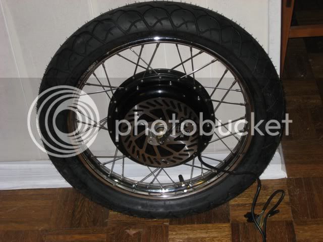

I think going with a wider hub like the aotema may be a better plan than the 9c type hub, mostly because of the flange width.
Hello JRH, that flange width thingy threw me for a bit. What ever else happens I gotta think about upgrading from the stock rim brakes on the Runt. I like the Maxi but I haven't got the scratch to pick it up yet.

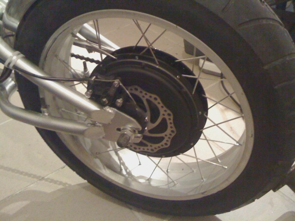

the rim brake is crap. i bought the conhismtor with the disc brake + mounting bracket for the caliper but it´s not much better than before. or maybe it´s just the crappy brake lever - i´ll try another one
took the chopper out for a test ride last weekend but i´m not so happy with the conshismotor kit. it´s the 500W 48V version - i should have bought another 1000w kit but my 1000W motor on my MTB drags 31 Amps and my smaller 10 Ah lifepo4 pack is only good for a constant 12A - that´s why i thought i could use the small pack on this low power bike and the big pack only on the two other bikes
testet the 500w motor and it drags 33,7 amps :x . no way to use it on my small pack as it cuts off as soon as i hit full load.i´m running it with my bigger but heavier pack now but although it drags 1.585 watts from the battery it´s not really fast - only 22mph using the throttle and a max. of 27mph with pedaling. the 1000w version on my MTB drags similar power and runs ~ 36mph with pedaling

Looks like a 160mm rear rotor there Pedalex. Man thats close. Take the chopper for a medium length ride and then go over the entire wireing with your hand feeling for warm spots. These would indicate resistance. Redo these weak areas with larger wire, or higher amp connectors and make sure the tires are pumped up to the max tire pressure. If that doesn't help, I feel you will need more battery power. These choppers are a heavy lot, and with an adult on top of that, you will need all the help you can get. Also, I read that Conhismotors aren't the most efficient out there. They appear to be quite power hungry, from what I read. :roll: Remember, the larger wheel on the GT will translate to higher ground speed with everything else being equal. I figured 22 mph was good speed for a 20 inch wheel. The high amp draw was the flag for me.

I would go for a larger rotor first though. I have the stock 180 mm. Tektro setup on the Spoiler, and all I need is one finger to stop it.

i measured it when the wheel was out and it was ~175mm.i think i measured a bit more than180 when the original wheel was in. but i guess now with the nuts tightened it has narrowed to about 160 maybe even less than that - just depends on how many washers i put in between the dropout and the brake caliper bracket which sits on the axle too. on the other side i have a 6 or 7 speed freewheel but only using the smallest one to get the chain in line. so the ~210mm axle is far more than i need with loads of thread left on both sides.
maybe i´ll go to my parents tomorrow and try to measure it again and get you some better pics - don´t have all the bikes here in town and most of my pics here are shot with an iphone so i´d better take a camera and get you some high-res pics.
Flange width- the distance between the two spoke flanges.
A forwarning for you, lacing a small wheel onto the rim will require you to use 48 or 66v for decent speed. The maxi mite from Terry would be a good choice if it fits IMO.
I don't have anything in stock that would fit your needs, I would suggest either something from Terry or a 400 series crystalyte (expensive!).

got you some more pics to show you there´s plenty of thread left on both sides of the ~210mm long axle
Nice chain tensioner Pedalex! I gotta hold out for a good 180 mm rotor fit there. I really feel blessed when someone puts forth the effort to post so many pics for my benefit. Pedalex, you really are a trooper.
right it´s a 160mm disc. i wanted to upgrade to 203mm but the conhismotor disc adapter (i PM´d you the link) only matches their 160mm discs. standard discs don´t fit although they have 6 bolts- the distance betwwen the holes is a few mm bigger on the conhismotor discs.
