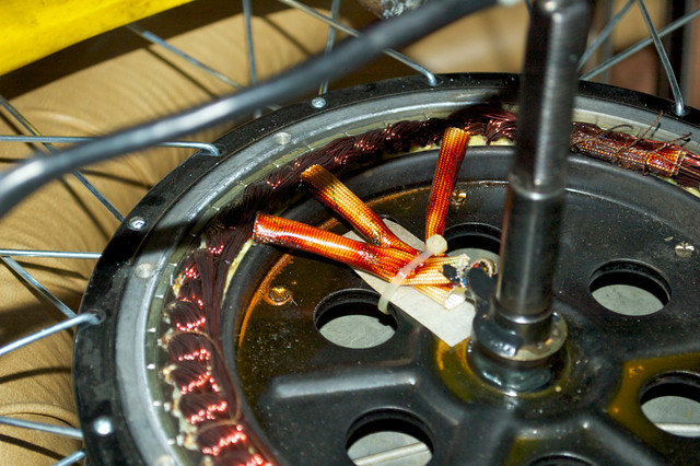

I just woke up and wenet right to popping open the motor. I remember smelling this very strong dog-bone smell in the insulation around the wire coming out near the motor. It appears liquid orange stuff came through the axle in the the insulation.... Well.. it's not good. the string holding the windings together is burnt.. it's crumbly... :cry:
I found a little drip of solder but I'm unsure where it came from... Probably in the white burnt sheaths? I'm not sure if it was facing this way or the other way.. I put it back to show you where I found it. I checked under the sheath to find that there was just a little less solder on one of them.. I now need to figure out how to pop off the other side to check the sensors.

To get the cover off on the other side, just push on the axle with a 3 jaw puller until the cover is up enough to get some wooden wedges under it and then, wedge it off. The uneven gap is because the cover is off.
I would have just tested the halls without opening the motor. Then you would have been testing the hall wires at the same time.
Now that you popped the motor open you might as well make it worthwhile and replace the spindly phase wires that 9C uses.
BTW there's no clip to remove. That's only for removing the axle from the stator. The only things holding the magnet backing ring and other cover on are magnetic attraction between the magnets and stator core along with the inner race of the bearing to the axle (which is typically an easy to slip on fit). That magnetic attraction is strong, so be careful.

I finally got the stator out.. The sensors have a little solder around them. some globs completely loose. One sensor has a glob that shorted out the left two pins (looking down). Is there a way of telling if a sensor is burnt out? Or is it most likely just disconnected?
Would one sensor shorting explain why all three LEDs did not light?

I finally got the stator out.. The sensors have a little solder around them. some globs completely loose. One sensor has a glob that shorted out the left two pins (looking down). Is there a way of telling if a sensor is burnt out? Or is it most likely just disconnected? YES, USE the LED
Would one sensor shorting explain why all three LEDs did not light? YES
