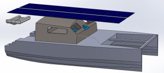

We plan a solar Catamaran (45' around 20k lbs) powered by Nissan Leaf or Hyundai Kona EV motor running from a 16S NMC battery (58V nominal).
I test a motor at 52V with a ASI BAC 2000 and it work well.
As we expect to cruise at 8-10 kW with peak at 20 kW from two motors, we need bigger motor controller (40 kW peak from two powertrain).
So I think about using a ASI BAC 8000 or EZKontrol EZ-C481200 (we learn that this 1200A controller only have 600A bus peak and 300A bus continuous).
Is there any other choice with similar functionality and price?
