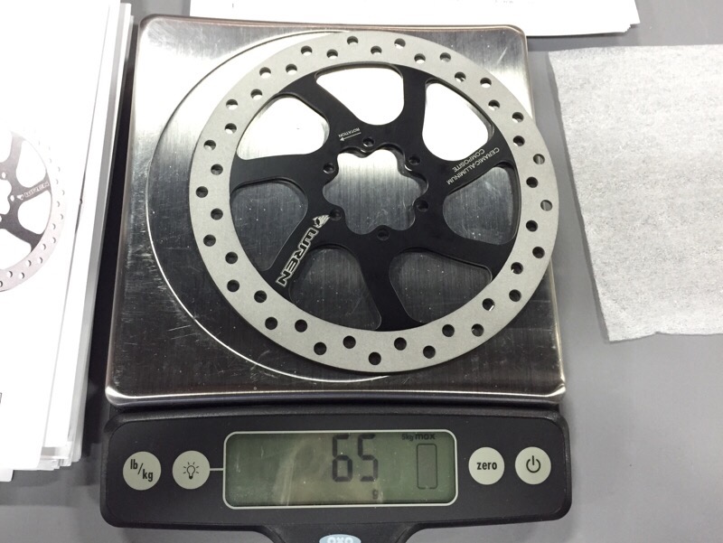

liveforphysics said:Most bicycle brake rotors I've seen looked like they had artists make the designs to look flashy rather than doing a mechanical stress optimization.
speedmd said:I would think a non or low chromium high tungsten grade HSS (High speed steel) best for a light rotor app.
Chalo said:speedmd said:I would think a non or low chromium high tungsten grade HSS (High speed steel) best for a light rotor app.
It needs to be bendable so you can align it (because nothing is perfect). And it should fail in a way that doesn't produce razor sharp fragments. HSS gets poor marks in both regards.

speedmd said:Stainless in general is a slippery material ( I deal with several grades daily ) and may be just a poor choice for ultimate performance and mainly used for cosmetic considerations.
speedmd said:One of the alloys I played with a few years back that may be worth a look on these super thin fast ebike rotor setups is 52100. It can hold shape, harden to medium hardness without brittleness creeping in. Strong and low chrome also. Interesting stuff.
Chalo said:speedmd said:Stainless in general is a slippery material ( I deal with several grades daily ) and may be just a poor choice for ultimate performance and mainly used for cosmetic considerations.
It's true that my best motorcycle disc brakes were some kind of carbon steel, made by EBC. They were better than stock in pretty much every regard I can think of.
Stainless alloys seem to tolerate surface wear relatively well; not as well as bearing bronze but better than plain steel. I'd be willing to try Ampco bronze or similar for disc rotors (expensive, but wear resistant and thermally more interesting than stainless). I've wanted to try that for a coaster brake hub shell for a long time.
I've never come across M2 high speed steel in any other state than glass hard, even after getting red hot in an ugly machining scenario. But I suppose that it's steel after all and thus can be annealed to some degree or another.
